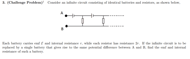

Find the equivalent model of an infinite ladder circuit

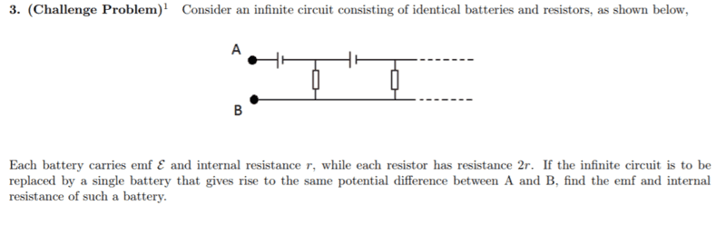

My solution is a bit long so I will just briefly explain it. First, we find the total equivalent resistance. Since the circuit extends to infinity, it is equal to replacing the second branch onward by a single resistor. After some calculus, Req = 2r. Thus, internal resistance is 2r. Next, apply the loop rule to find the current before it terminates as it is physically impossible for the current to blow up to infinity. Effective emf is found to be 2Ir = 2ε.
My question is, is there perhaps another (shorter) way to solve this problem? If so, please explain your solution. Thanks!

The Blind Watchmaker said:
2. Homework Equations
Ohm's law and Kirchoff's voltage law

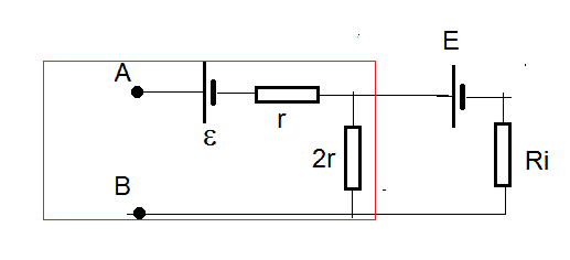

Your method and your results are correct. You can use Thevenin equivalent. Adding the unit in the red frame to the equivalent source of emf E and internal resistance Ri, the emf and internal resistance of the Thevenin equivalent between A and B are E and Ri, respectively.

Can you show what you mean by replacing the "2nd branch" with a resistor? Perhaps post a picture.
ehild said:
You can use Thevenin equivalent. Adding the unit in the red frame to the equivalent source of emf E and internal resistance Ri,...
Now I'll buy that. I appeared as if the OP was going to replace everything beyond the first source with just a resistor.
