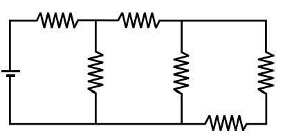

Find the equivalent resistance of the circuit shown below. Each of the six resistors has a resistance of 12 ohm.
I just want to make sure I calculated everything right. I don't have the solution available.
Labelling the resistors from my left to the right: R1, R2, R3, R4, R5(bottom), R6
What I did:
R5 + R6 = R56
1/R56 + 1/R4 = R456
R456 + R3 = R3456
1/R3456 + 1/R2 = R23456
R23456 + R1 = Req = 20Ω
Thanks!
