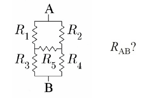

I have a question about an exercise I don't understand, I don't want the solution, only the first element to begin.
I have tried with kirchhoff law, but I failed.
thanks
Remember that you need to show some effort on schoolwork-type problems. If there are certain symmetries in this bridge circuit, you can sometimes simplify it. But in general you would use KCL or similar to solve it. Can you show us how to use KCL to solve it?

If I start with these equation, assuming current I_i for i = 1,2,3,4,5, and using KCL and what I know about circuit and correlated laws:
I have:
I_1 + I_2 = I_{tot}
I_1 = I_5 + I_3
I_2 + I_5 = I_4
I_3 + I_4 = I _{tot} and for general I have:
## R_{tot} = \frac{V_{AB}}{I_{tot}}##
with the equation:
R_1 * I_1 + R_3 * I_3 = V_{AB}
and so on, for total of 4 equation, each equal to V_{AB}
By now, is correct my resolution?
to me seem very strange
P.S. excuse for some LaTex code but seem not work, If you help me also with this :)
What you have written is correct (although I would give points off for your failure to SHOW the currents even though it's pretty clear that you are using a reasonable convention). BUT ... what does that have to do with the equivalent resistance? You are not asked to give a bunch of equations, you are asked to give ONE equation of the form
[itex]R_{eq}[/itex] = <whatever>
Yes, ##R_{tot}## that I have written is the ##R_{eq}##, but to find that resistance... I tried with KCL with that bunch of equation, but I don't arrive at the end because there always too much variable in the equation I found ( e.g. for replacement)
Do you know about delta-Y transforms?
Likes FactChecker
According to my professor they come later.. so first I should able to resolve this exercise, but I don't understand how
Well, since you can't just USE the transform equations, it is now up to you to derive them. This will allow you to break your problem into two parts --- one fairly messy, the transform equations, and the other very simple conceptually but still involving messy equations in this case because you have so many unknowns.
Take the upper 3 resistors as a delta and convert that to a Y. That's the hard part. Then you have a very simple series/parallel circuit that is algebraically trivial but which will look messy as all get-out in this case because of the 5 unknowns you have to carry around.
The progression will look like this:
Literally speaking, the delta and Y are upside down in this case, but they are still delta and Y in electronics.
Likes FactChecker and aaronll
I should add, by the way, that there is usually more than one way to solve simple circuits like this and I've just given you my way because I think it's the easiest but that's 'cause I'm used to delta-Y transforms.
Likes aaronll
Finally I understand how to find the equivalent resistance with the delta - star transformation... but it was sufficent to say "Superposition on nodes" , because with that is totally clear.
Anyway thanks for the help.

I think the question was asking you, prompting you, to define, that is to write out the equation for equivalent resistance. Just for the sake of a logical and suggestive order of procedure.
Then this definition contained so it's related to things you have already written and you can start to fill in, substitute et cetera. As I said, just one way of proceeding there are more
