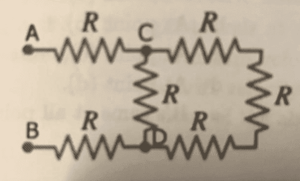

Find the equivalent resistance of this circuit between points a and b
https://imgur.com/a/LWcIC
I am not sure how to complete this problem without any variables. I tried replacing the numbers with the variables which is what I think your supposed to do but It still isint making sense.

I'm not sure what you mean about "without any data". Can you just solve the question using series & parallel combinations of resistors? Since they are all equal to "R" in value, that makes it pretty easy...

But I am not sure what I am supposed to get as an answer will it just be in terms of R?

The answer you are looking for will be in terms of the resistance R. In other words it will be something like 7*R or 19*R/5, or something like that. Try using series/parallel combinations to reduce the resistance between a and b to a single resistor.

Yes. If there were just 2 resistors in series, the answer would be "2R". If there were just 2 resistors in parallel, the answer would be "R/2". Right?

https://i.imgur.com/ubVARZs.jpg there's my answer I got 6R but I am not sure if I combined the resistors correctly.​

That can't be right, since if the middle parallel resistor were not there, the other resistors would add up to 5R.
The sideways image is a bit hard to read. Can you just type your work into the forum window please?
Sorry I Labeled it as following R1 and R2 are the top in series R3 R4 are the two middle ones in parallel and R5 and R6 are the bottom two in series. I did R12= 2R
R34= (1/R+1/R)-1
R56=(1/R+1/R)-1
R123456= (1/4R + 1/2R)-1

No, that doesn't look right, and I honestly am not following what you are doing.
Start by combining the right-hand 3 resistors into one. What is the value of those 3 series "R" resistors? And now, is that combined resistance in parallel with anything?

Okay. So...
R1 is between nodes A and C.
R3 is between nodes C and D.
R5 is between nodes B and D.
And @berkeman is asking you to find the combined resistance or R2, R4, and R6.
You are taking a bad turn in you approach. The first thing you should do is to collapse the loop on the right to a single resistance between C and D. After that, you will have a simple problem of 3 resistances in series. Branching nodes are always a problem and you should first work on small parts toward an equivalent problem that replaces the branches with a simpler diagram.
