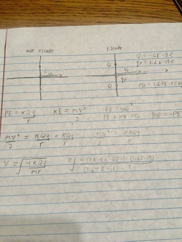

2 charges of -6nC are placed on the y-axis, on .005m above, and one .005m below the origin. A proton is launched from origin to the right along the x-axis. What is the escape velocity (m/s)?
PE = kQq / r
KE = mv^2 / 2
Below is the work I've attempted. I used 2 PE b'c there were 2 point charges, and only one KE b'c only the proton is moving. The final equation in case it's hard to see is V(esc) = sqrt (4kQq / mr).
I'm not sure if I did it right. Did I set up this equation right? and I am also not sure what to plug in for "r".

You wrote that ##\sum E = W_{\rm nc}##. But, this is not quite right.
##W_{\rm nc}## is the work done by nonconservative forces as the system changes from some initial configuration to some final configuration. ##W_{\rm nc}## equals the change in total energy ##E## of the system as the system goes from the initial to final configuration.
That is, ##\Delta E = W_{\rm nc}## ##\,\,\,\,\,## (The ##\Delta## symbol is essential here.)
You know that ##W_{\rm nc} = 0## for this problem. Thus, ##\Delta E =0##.
This means that ##E_i = E_f## ##\,\,\,## or ##\,\,\,## ##KE_i+PE_i = KE_f + PE_f## ##\,\,\,\,##(conservation of energy)
You are given information about the initial configuration. You will need to decide what to take for the final configuration. Then consider what to write for ##KE_i##, ##PE_i ##, ##KE_f##, and ##PE_f##.
If you are clear on the initial and final configurations, then you should be able to see what to use for ##r## in ##PE_i## and ##PE_f##.

Ah, okay I mixed up change in and sum of.
I tried this again and I must be thinking screwy b'c the final KE I figured to be 0 since V final would be approaching 0, and the final PE I figured to be 0 since r final would approach infinity.
I also ended up with 0 initial PE b'c the top and bottom charges would cancel out.
I don't know what I'm doing.
That all sounds good.
Think about this some more. What's the initial PE for the proton and the charge Q at y = .005 m? What 's the initial PE for the proton and the charge Q at y = -.005 m?

Right, negative distance isn't possible, they'd only cancel if the charges were opposite. Thank you!
