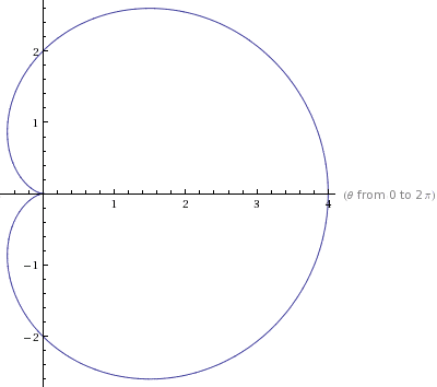

Like HallsofIvy said, you should plot the polar curve: r=2(1+cosθ) to find the limits of integration. I have attached the graph to this post.
