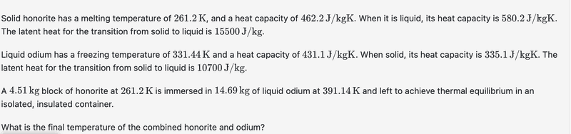

Solid honorite has a melting temperature of 261.2K, and a heat capacity of 462.2J/kgK. When it is liquid, its heat capacity is 580.2J/kgK. The latent heat for the transition from solid to liquid is
15500J/kg.
Liquid odium has a freezing temperature of 331.44K and a heat capacity of 431.1J/kgK. When solid, its heat capacity is 335.1J/kgK. The latent heat for the transition from solid to liquid is
10700J/kg.
A 4.51kg block of honorite at 261.2K is immersed in 14.69kg of liquid odium at 391.14K and left to achieve thermal equilibrium in an isolated, insulated container.
What is the final temperature of the combined honorite and odium?

This is incorrect. Could someone please help me figure this out?
Thanks

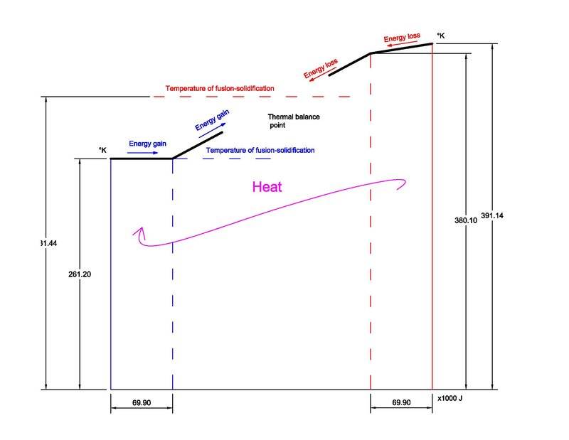

I believe that those 69 905 J of needed melting heat transferred into the melting solid Honorite are not able to cool down the liquid Odium that much.
Immediately after all the initially solid Honorite is melted, that cold liquid mass will steal more energy (at a different rate) from the hotter liquid mass of Odium, tending to a temperature balance point (unless Odium freezes before reaching that point).
