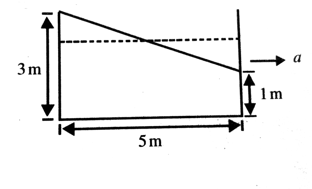

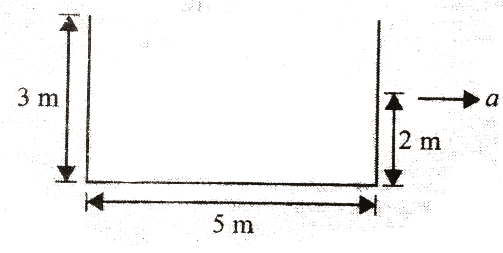

A container of height 3m and width 5m is filled with water upto 2 m. It is accelerated such that the water is at the brim (it is about to spill). When it moves with this acceleration find the force acting per unit width on the vertical wall.
I got ##a = 4 \frac{m}{s^2}##
I found the acceleration for the condition provided but how to find the force per unit width?

So what expression did you get for force per unit width? What number do you get when you plug in the data?
I think I was wrong before. We will be getting the following expression : ##F = ρALa ## where ##A= h.b## is the area, ##L=5## is the length, ##a## is the acceleration.
## \frac{F}{b} = ρ.h.L.a = 6 * 10^4##

Yes, I hadn't checked post #3 because TSny confirmed it. He must have thought your A was the base area.
Kaushik said:
F=ρALa
Ok, but what is A here? Think about the volume of the water.
Likes Kaushik
Oh , the volume of water is different. Should I consider the ##A## of trapezium?
In the above expression I considered area of the wall (left) . I think it would be better if I consider area of the trapezium and multiply it by width to get Volume.
So ##V = A_{trapezium} * b = 10b##
## F = ρVa = 10ρba \implies \frac{F}{b} = 4 * 10^4 N/m##

That is the right answer, but you did not need to use the trapezium formula. The volume is not changed by the acceleration.

What about the Force due to pressure due to g? (sorry for not writing the units once again)
Whoops! You are right. All you have found is the additional force due to the acceleration. You need to add in the force when there is no acceleration.

I think I totally misinterpreted the problem statement. I thought it was asking about the force per unit width required to accelerate the system if you neglect the mass of the container and assume no external friction acting on the system. I thought of "width" here as referring to the dimension of the container perpendicular to the diagram.
I'm still not sure about the meaning of "the force per unit width acting on the vertical wall". Are they asking about the force caused by the fluid pressure on the 3 m x 5 m wall while the system is accelerating? In that case, it seems odd to me to ask for the force per unit width rather than just the force.

My understanding is that they are asking about the force on the left hand vertical wall against which the water is piling up. Expressed as force per unit depth-into-the-paper-drawing. It seems to me that there is an insight which can reduce much work and allow the answer to be readily extracted with almost no calculation required.
Let me try to give a huge hint at the relevant insight by asking some easy questions. What is the pressure at the top of the fluid piled up at the left wall? What would the vertical pressure gradient be if the fluid were exposed to a vertical gravitational field with magnitude g with no horizontal acceleration? How does that vertical pressure gradient change when the tank is exposed to a horizontal acceleration as well?

I got the vertical pressure gradient when there is no horizontal acceleration. But when there is horizontal acceleration won't that add up to the force that is already present?
The [vertical component of the] pressure gradient is unchanged by the presence of the horizontal acceleration, yes.
That does not mean that the total force on the left hand wall is unchanged when more water piles up on it. But it does mean that you can easily calculate the total force on the left hand wall based on the depth of the water against the wall.
