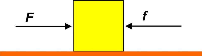

Static friction
The static friction force grows to maximum if F is increased steadily.
Just before the object starts moving it is given by
f = μS N
This means that the acceleration will be zero just before the furniture starts to move.
Only at this point can you evaluate the static friction.
Just before the furniture will start to move we can then say that
F = f
or
F - f = m[itex]\:[/itex]a
[itex]\ [/itex]= 0
This means that in you formula
M1:
ƩFx=m1*ax
m1*ax=Fcos(25)-fs(g on 1)-F(2 on 1)
you can set ax to zero. Also F(2 on 1) will be zero since the friction balances the horizontal component of the pushing force out. This means that the 1st piece of furniture is not pushing the second one yet.
