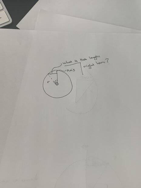

annamal said:
$$I = \int{r^2dm}$$
Where r is what, exactly?

But the distance from an arbitrary point within the sphere to its centre is not (in general) the distance from the point to a given axis through the centre.

OP as both posters before me mentioned: ##r## is the distance to the axis.
Are you familiar with spherical coordinates? (If not then get familiar with them ASAP). Be mindful of the different conventions (math vs physics).
##\theta## is the angle from the z-axis going from ##0## to ##\pi##. Draw an arbitrary radial vector and find the component that is perpendicular to the z-axis.
Because there is now angular dependence your new ##dV## will have to reflect that.

I don't understand that. Can you draw something to illustrate that?
We were hoping that you yourself would draw a picture to clarify it in your mind but I will give you a word picture to get started.
Imagine a sphere. Draw a pole through the center in some direction. Now, pick an arbitrary point inside the sphere somewhere. Now draw a line segment from the center of the sphere to that point. Draw another line segment from that point to the pole which is the minimum distance between the point and the pole, i.e. not generally through the center. If your point was an arbitrary point, they should be different lengths.
Yes I see that.
##dV = 4\pi y^2 dy##
so ##I = \int{r^2dm} = I = \int_{-R}^{R}{R^2 - y^2}*\sigma 4\pi y^2 dy##
Is that correct?

Your diagram should also illustrate the elements you are summing.
In principle, this is a volume integral. You can reduce it to a double integral using rotational symmetry about the sphere's axis of rotation, but you still have two largely independent variables of integration: the height y from the equatorial plane and the distance of the mass element from the axis. They interact only in that the height affects the range of the radius.
Edit:
From ##dV = 4\pi y^2 dy##, it looks like you are using a spherical shell as your volume element. That cannot work because not all parts of it are the same distance from the rotational axis. Start with a ring element, or a cylindrical shell.

Closer but not exactly correct yet. How did you get ##dV = 4\pi y^2 dy##?

PhDeezNutz said:
r (distance indicated) = ##\sqrt{r^2 - y^2}##
Thus

First, what follows from ##V = \frac 4 3 \pi r^3## is that ##dV = 4\pi r^2 dr##.
Secondly, as I pointed out in post #13, ##4\pi r^2 dr## would be a spherical shell element. That is of no help since different parts of it are at different distances from the axis of rotation.
Btw, I have been assuming this is for the moment of inertia of a solid sphere. Please clarify whether it is that or a spherical shell. Your answer is wrong either way.
