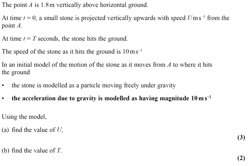

see attached.
Mechanics

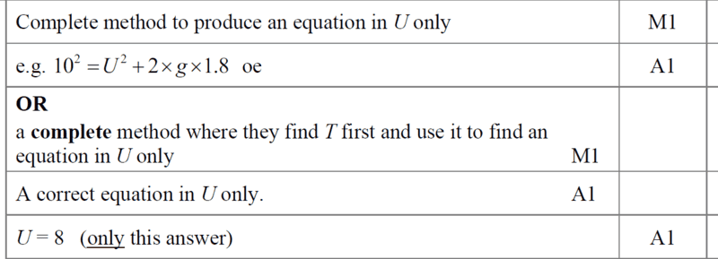

Now in determining the initial velocity;
in my understanding, if ##s=1.8## then we consider the stone's motion from the top to the ground. Why not consider ##s=3.6##, the total distance traveled by stone from start point ##t=0##? Is it possible to model equations from this point?
The stone when thrown upwards will reach a point where it is instantaneously at rest and then start the descent. In that case, it is clear that ##s=1.8##. I need insight on this very part.
chwala said:
Why not consider ##s=3.6##, the total distance traveled by stone from point ##t=0##?
Because in the kinematic equations the relevant variable is the displacement (a vector) not the distance (a scalar).

Then I will add here a calculation that illustrates the point in post #2.
Problem
A stone is thrown straight up in the air with initial velocity ##v_0=3~##m/s and returns to the point at which it was launched. Find the time time of flight ##T##.
Solution
The height of the stone ##y## at any time ##t## above the point of launch is given by $$y=v_0~t-\frac{1}{2}g~t^2.$$ At the specific time ##t=T## when it returns to the launch point, the height of the stone above ground is zero. With ##t=T## the equation we have $$ 0=v_0~T-\frac{1}{2}g~T^2\implies T(v_0 -\frac{1}{2}g~T)=0.$$ One or the other of the terms in the product on the right must be zero.
A. ##T=0## which says that the stone is at zero height when it is launched, a fact that we already knew and built in the equation. We reject this solution because we are looking for a time after launch, i.e. ##T>0.##
B. ##v_0 -\frac{1}{2}g~T=0 \implies T=\dfrac{2v_0}{g}.## This is the solution that we want.
Answer
##T=\dfrac{2\times 3~(\text{m/s})}{10~(\text{m/s}^2)}=0.6~\text{s}.##
You can see from this example that the total distance traveled up and down does not enter the picture and is not needed. Good luck with your self-study. We are here to help.
