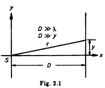

Let a spherical wave propagate from the origin, $y = ADcos(wt-2\pi r/ \lambda)/r$. Also, let a plane wave propagate parallel to the x axis, $y = Acos(wt-2\pi r/ \lambda)$. At x = D there is a flat screen perpendicular to the x axis. Find the interference at the point y on the screen as function of the interference at y=0.$$ E = (A e^{i(wt-2\pi D/ \lambda)} + AD/r e^{i(wt-2\pi r/ \lambda)} ) $$
$$ I = Q* (A^2 + (AD/r )^2 + 2AD*A/r cos{(2\pi D/ \lambda -2\pi r/ \lambda)} ) $$
Now, i pretend to use $$r \approx D$$ outside the cos, and $$r = \sqrt{ D^2 + y^2} \approx D(1+(y^2)/(2*D^2))$$ inside it.
So that $$ I = Q* (A^2 + A^2 + 2A^2 cos{(2\pi (y^2)/(2*D \lambda))} ) = 2A^2(1+cos{(2\pi (y^2)/(2*D \lambda))}) = 4A^2cos(\pi (y^2)/(2*D \lambda) = I_o cos(\pi (y^2)/(2D \lambda)) $$
THe problem is that the solutions is ##I_o cos(\pi (y^2)/(D \lambda)) ## And i have no idea where is my mistake.

Herculi said:
$$2A^2(1+cos{(2\pi (y^2)/(2*D \lambda))}) = 4A^2cos(\pi (y^2)/(2*D \lambda) $$
Shouldn't the cosine function be squared on the right-hand side?
Otherwise, your work looks correct to me. In particular, I think the factor of 2 in the denominator of the argument of the cosine function is correct.
Did they have a square on the cosine function? If not, it is clearly wrong since the intensity cannot ever be negative.
Likes LCSphysicist
Yes, i forgot the square in both answer. Thank you, so aparenttly the answer given by the book is wrong in fact.
It appears that way to me. Maybe someone else will confirm it.
