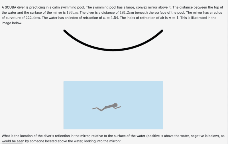

A SCUBA diver is practicing in a calm swimming pool. The swimming pool has a large, convex mirror above it. The distance between the top of the water and the surface of the mirror is
193cm. The diver is a distance of 181.2cm beneath the surface of the pool. The mirror has a radius of curvature of 222.4cm. The water has an index of refraction of
n=1.54. The index of refraction of air is n=1. This is illustrated in the image below. What is the location of the diver's reflection in the mirror, relative to the surface of the water (positive is above the water, negative is below), as would be seen by someone located above the water, looking into the mirror?
Dapparent = Dreal / n
f = -R / 2
1 / f = 1 / do + 1/di
Dapparent = 181.2 / 1.54 = 117.66 cm
the total distance from the mirror to the diver is: do = 193 cm + 117.66 cm = 310.66 cm
As the object is in front of the convex mirror, do = -310.66 cm
f = -R/2 = -222.4 / 2 = -111.2 cm
1 / -111.2 = 1 / -310.66 + 1/di
di = -173.1938 cm
location is 193 cm -173.1938 cm = 19.80 cm
But this is not correct. Could someone please help me spot my mistake here.
Thanks!

Question: How would your calculation differ if there were no water in the pool?
Answer: It would not. Does this make sense to you?
Sorry I didn't quite understand what you mean

If you were suspended 193cm above the pool, where would the diver appear to be?
haruspex said:
Now you are just making wild guesses.
directly beneath me so would that be 310.66 cm as it accounts for the refractive index?
Yes. So what's next?
Finding di using the lens equation which I got as -173.194cm?
Sorry, I just realised you did all this in post #1. I was misled by the ensuing posts and failed to check back all the way.

It just dawned on me that the info at the link I posted cannot be right. If we set f to infinity we should get di and do as equal but on opposite sides, i.e. flat mirror.
Here's what it should say:
"1/f=1/di+1/do where all three are measured as distances in front of the mirror."
So we have f=-111.2, di=310.7, and di will turn out negative, meaning it is |di| above (behind) the mirror.
Note that in all convex mirror cases f will be negative and do positive, so di is guaranteed negative.

Nevermind I got the right answer, Thanks a lot for your help :)
