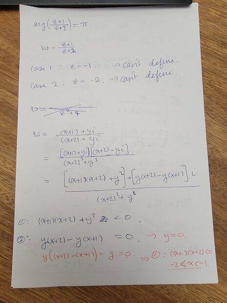

Find the locus of the points arg((z+1)/(z+2)) = pi
z = x + iy, realising the fraction of complex numbers, using the arg = pi condition.
I tried the following proof and got -2 < x < -1 and y = 0 but my prof said that there should be something else I am missing. I have no idea what that is. Thank you.
I agree with your final answer but I don't think I agree with your equation for ##w##. It's not immediately clear to me what you were doing there.

I set z = x + iy for real numbers x and y, and then did the calculation.
I don't see what's missing.
I couldn't find an error or another possibility either. I double-checked with WolframAlpha and it only confirmed the result.
All right. I haven't really thought of verifying with Wolfram Alpha. Yes that should confirm, I don't know, just my professor said that and I wasn't sure. Thank you anyways!

You might be interested in another way that I think is simpler:
1) Solve ##w=(z+1)/(z+2)## for ##z##. That gives ##z=(-2w+1)/(w-1)##.
2) Knowing that transformations of this form map straight lines and circles to straight lines and circles, map a few points along the line of arg(##w##)=##\pi## (that is ##w \lt 0##). Include the endpoints of interest to see what line segment or circle arc you get. ( 0 => -1; -1/2 => (2)/(-3/2)=-4/3; -##\infty## => -2)
Transformations ## z => w## of the type ##w=(az+b)/(cz+d)## in the complex plane are called bilinear transformations (Mobius transformations). They have nice properties that make them very convenient to use.
Consider when ##x=\pm \infty##
