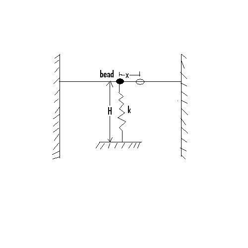

a rope is tied between 2 walls as shown.a bead of mass 'm' is on the rope as shown. it is constrained to move in the horizontal direction. it is tied to a spring of force constant 'k'- N/m. the spring is initially at its free length 'H'. the bead is displaced by a small displacement 'x' in the horizontal direction. does it execute SHM.If so find the magnitude of small oscillations?
no friction.
the figure is attached!
T =2 pie/omega
Consider the spring to make an angle q with the vertical
The mass in equilibrium in the y direction at all the times
Fsin q = mg
F (h/l)=mg
F = mgl/h
-Fcosq = f_restoring
-Fx/l = f_restoring
-mgl/hl *x =f_restoring
-mgx/h = f_restoring
-mgx/h = ma
ma+mgx.h = 0
a differential equation
omega = sqrt (g/h)
T = 2 pie * sqrt (h/g)
Now the answer is dimensionally correct
method 2
Since the force exerted by the spring is the vectorial sum of the forces along both the directions
F_y/(F_x) = tan q
-F_x= f_restoring = F_y/(tanq)
F_y intially is mg
f_restoring = -mgx/h
so this would be give
T= 2 pie *sqrt (h/g)
An amazing result independent of the spring constant of the force
A spring can only influence the motion along the direction of the spring
Is the solution?? if yes can anybody explain what it means

Hello,
I have a result which shows that the motion is NOT a simple harmonic moiton.
Because the net force on the bead is proportional to [tex]x^3[/tex].
This is just my opinion.
Regards
Can u please give your method
This is the first sign something is wrong. Looking at your equations, I can't find anything that actually states the force the spring acts on the object (if it's there, it's certainly missing the spring constant
Is the motion simple harmonic??Please help me
I'll give you a hint
F_y intially is mg
Wrong! There's a spring pulling on it too
