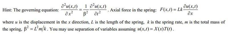

Consider the spring-mass system shown. A dynamic load, P(t), is applied with a frequency of 300 rpm. The helical compression spring is made of a music wire. When installed, the spring force is to vary between 100 and 500 N while the spring height varies over a range of 10 mm. The object attached to its end has a mass of 1.7 kg.
Derive an expression for natural frequency.
None. There might be some unnecessary information in the question, I'm not sure. This is an example from my machine design course.
I know that a spring's natural frequency is 1/2∏ √(k/m). But I don't know this applies to this question.

EDIT: Oh, also this was given as well. But I have no idea at all how to use it.
physicist10 said:
That puts a very different slant on the problem. You cannot deduce k directly from the extension and tension data given. The spring has mass, so a wave arises within the spring. The applied load frequency interacts with this to affect the tension.
You will need to obtain solutions to the differential equation. You understand separation of variables?
Actually not quite. Are we trying to obtain F(x,t)?

What is the mass? Is it the mass of the spring + mass of the brick?
Your problem statement only mentions the mass of the block, M, but the 'hint' says the spring also has mass, m.
And if I understood correctly, the external force applied has no effect on the natural frequency.
That's true, but how are you going to calculate it? You are not told k, and you cannot deduce it directly from "the spring force is to vary between 100 and 500 N while the spring height varies over a range of 10 mm". That piece of information only relates to the forced mode of oscillation. So you need to solve the equations for this forced mode, use that information to determine k, and thus find the natural frequency.

In the 'governing' differential equation, make the substitution for u they suggest. Obtain a general solution and apply the boundary conditions. Can you see what the boundary conditions are?
I make the substitution and apply the multiplication derivative rule?
I know that one boundary condition is u(0,t)=0. Are there more?

You can derive an expression for F(L,t).
