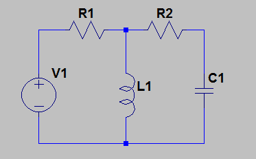

Find the natural response
V1 is a squarewave
KCL, KVL
How would I find the natural response using differential equations?
Am I doing it right?
by KCL
[tex]\frac{V_1-V_{in}}{R_1}+\frac{1}{L}\int_{0}^{t}V_1(t)dt + \frac{V_1-V_2}{R_2}=0[/tex]
[tex]\frac{V_2-V_1}{R_2}+C\dot{V_2}=0[/tex]
[tex]V_2-V_1+R_2C\dot{V_2}=0[/tex]
[tex]V_1=R_2C\dot{V_2}[/tex]
substitute to original eq.
[tex]\frac{V_2}{R_1}+\frac{R_2C\dot{V_2}}{R_1}+\frac{1}{L}\int_{0}^{t}(R_2CV_2+V_2)+C\dot{V_2}=\frac{V_{in}}{R_1}[/tex]
take first derivative of everything
[tex]\dot{\frac{V_2}{R_1}}+\ddot{\frac{R_2CV_2}{R_1}}+\dot{\frac{1}{L}(R_2CV_2+V_2)}+C\ddot{V_2}=\dot{\frac{V_{in}}{R_1}}[/tex]

Is my work thus far correct?
You didn't start by saying what "natural response" means.
You didn't say what reasoning you used to build those equations.
Therefore - I cannot tell.
You should annotate your maths.

"By KVL" is only good enough if your notation is self-explanatory. eg. You provided a diagram... but...
I see a ##V_1## on your diagram, but I do not see a ##V_{in}## nor a ##V_2## - but ##V_2## and ##V_{in}## both appear in your equations.
I also see no C or L on the diagram, but they appear in your equations. I could guess ##C=C_1## and ##L=L_1## but how can I be sure given above?
It also means I cannot be sure that the ##R_1## and ##R_2## in your equations refers to the same things on the diagram - since it seems nothing else does.

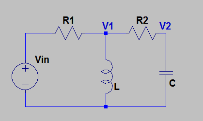

My bad. ##V_1## on the diagram should be ##V_{in}##. C should be C1 and L should be L1. I drew the diagram on LTspice differently than what I had on paper (I worked it out on paper before typing it up). This should be the proper diagram:

I should have written Node V1, as I was applying nodal analysis.

The natural frequency is ##w_o=\frac{1}{\sqrt{LC}}##
If you are asking for the numerical value of ##w_o##, I do not have it. The prompt is to find the differential equation corresponding to the natural response. We are to find the answer in the form of something like: ##\ddot{V_{natural}}+\frac{1}{RC}\dot{V_{natural}}+\frac{1}{LC}V_{natural}=0##
