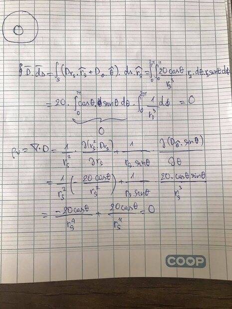

Relevant equations in a photo below. I try to solve it but the result is 0 which makes me confused
When taking the divergence, note that the ##\theta## component of ##\mathbf D## has a numerical coefficient of 10, not 20.
After you find the charge density, you might be able to see whether or not a zero answer for the flux through the spherical surface makes sense.
What do you get for part (b)?
Sorry. I now see where the factor of 20 comes from in evaluating the ##\theta## component of the divergence. Your work looks OK to me.

I think it must be 20 because when taking partial derivative of D(theta component)*sin(theta) respect to theta we can obtain derivative of sin(theta)^2=2sin(theta)cos(theta). This is the first time I post thread so excuse me about the math formulas

thank you. Can you give me some hints to do part (b), please?
Yes, you are right. Your work looks correct.
