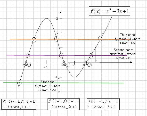

I really like it you mentioned that to solve for $x$ in \(\displaystyle f(f(x)) = 0\) is equivalent to solve for \(\displaystyle f(x) = x_i\) where \(\displaystyle x_i\) for i = 1, 2, 3 are the (real) roots of f(x).
And if I may use this idea to solve for the problem, I found out the total number of real roots for \(\displaystyle f(f(x)) = 0\) are 7 as well, and this method is so much better than my first approach and thank you, Balarka for showing me something that I don't know!
Solving for the number of real roots of \(\displaystyle f(x) = x_1=root_1\) means the same thing as finding the number of intersection points between the curve $y=f(x)$ and $y=root_1$, as shown by the green line and we see that in this case we have only one real root for \(\displaystyle f(x) = x_1=root_1\).Solving for the number of real roots of \(\displaystyle f(x) = x_2=root_2\) means the same thing as finding the number of intersection points between the curve $y=f(x)$ and $y=root_2$, as shown by the purple line and we see that in this case we have only one real root for \(\displaystyle f(x) = x_2=root_2\).Solving for the number of real roots of \(\displaystyle f(x) = x_3=root_3\) means the same thing as finding the number of intersection points between the curve $y=f(x)$ and $y=root_3$, as shown by the orange line and we see that in this case we have only one real root for \(\displaystyle f(x) = x_3=root_3\).
So there are a total of 7 intersection points and hence there are 7 real roots for \(\displaystyle f(f(x)) = 0\)!

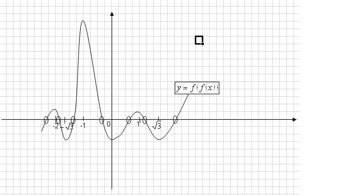

My first approach revolves around checking the nature of the curve of the function of $f(f(x))$ from its first and second derivative expression. If we let $f(x)=x^3-3x+1$ and $g(x)=f(f(x))=(f(x))^3-3(f(x))+1$, we find

$g'(x)=3f(x)^2f'(x)-3f'(x)=3f'(x)((f(x))^2-1)$
$\rightarrow g'(x)=0$ iff $x=\pm1$, $x=\pm \sqrt{3}$, or $x=-2$ or $x=0$.
$f''(x)=6x$$g''(x)=6f(x)(f'(x))^2+3f''(x)((f(x))^2-1)$

And plot a rough sketch to determine the number of real roots of the function of $f(f(x))=0$:
From the graph we can tell there are 7 real roots of the function of $f(f(x))=0$.
