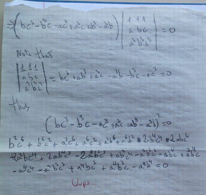

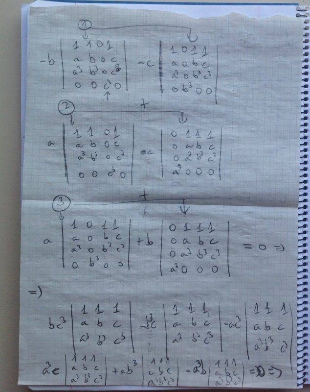

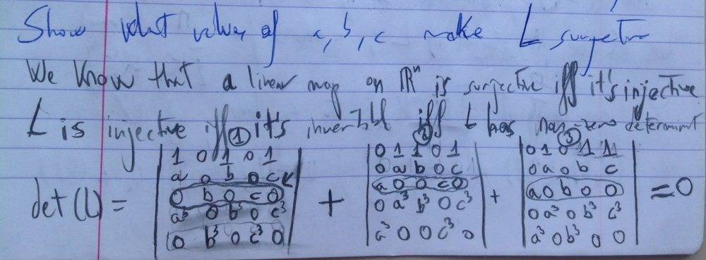

Alright so after some thought I only came up with the brute method
Mmm yikes! Am I now supposed to check all parameter values for which this 20-terms equation becomes zero? (the only apparent case is when ##a=b=c=0##)
I guess there's a much neater way of solving this...
First, you can see by symmetry of the original matrix that if any two of ##a,b,c## are equal then the determinant is zero.
I reorganised the determinant into a block form, with a 3 x 3 matrix in the top left and the same 3 x 3 matrix in the bottom right, and everything else zero. That reduces the problem to a 3 x 3 determinant.
Mmm why? I am afraid I do no see it... I guess that it has to do with a property of the determinant; I know that if any row/column of the determinant is zero then the determinant is zero.
Could you please show/explain how to do so? :)
If ##a = b##, then the second and fourth columns are equal. By a simple column operation of subtracting one from the other you get a zero column.
Likes JD_PM
1) Swap the columns until the first row is ##1 \ 1 \ 1 \ 0 \ 0 \ 0##.
2) Swap the rows until the second row is ##a \ b \ c \ 0 \ 0 \ 0## and the third row is ##a^3 \ b^3 \ c^3 \ 0 \ 0 \ 0##.
Likes JD_PM
