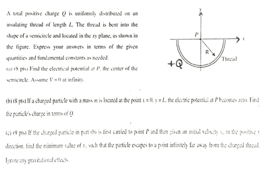

I have found the first following, I need b and c. The question is:
A total positive charge Q is uniformly distributed on an insulating thread of length L. The thread is bent into the shape of a semicircle and located in the xy plane, as shown in the figure. Express your answers in terms of the given quantities and fundemental constants as needed.
I found a following.
b.) If a charged particle with a mass m is located at the point x=0, y=L; the electric potential at P becomes zero. Find the particle's charge in terms of Q.
c.) If the charged particle at (b) is first carried to a point P, and then given an initial velocity v0 in the positive y direction, find the minimum value of v0 such that the particle escapes to a point infinitely far away from the charged thread. Ignore any gravitational effects.
Electric potential of semicircle at P point in the first following :
V= kQ/R
For the b following:
kQ/R=kq/L
L=πR
kQ/R=kq/πR
πQ=q

kQ/R=kq/L
How does that make the net potential zero?
Because, the electric potential due to the semicircle at P point is (kQ/R) and, due to the q charge is (kq/L). So I equalized them. Is that wrong for electric potential?
How do the two potentials sum at point P?

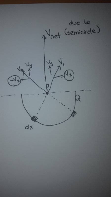

The direction of electric potential due to the semicircle is in +y direction. Because the Vx components will cancel due to the symmetry. Like in the image.
Potential has no direction. I'ts a scalar value.
You're the second person today to think that potential has a direction. It has a sign, based on the sign of the charge, but it's not a vector. It doesn't have ##V_x## and ##V_y## components.

And to make the potential zero at the point P, there should be electric potential at opposite
(-y)direction due to the charged particle at (x,y)=(0,L)
PeroK said:
You're the second person today to think that potential has a direction. It has a sign, based on the sign of the charge, but it's not a vector. It doesn't have VxVx and VyVy components.
So how to make electric potential zero at P?
You could use a charge of the opposite sign.
Oh okay. So the equation is the same except the sign of the second charge?
