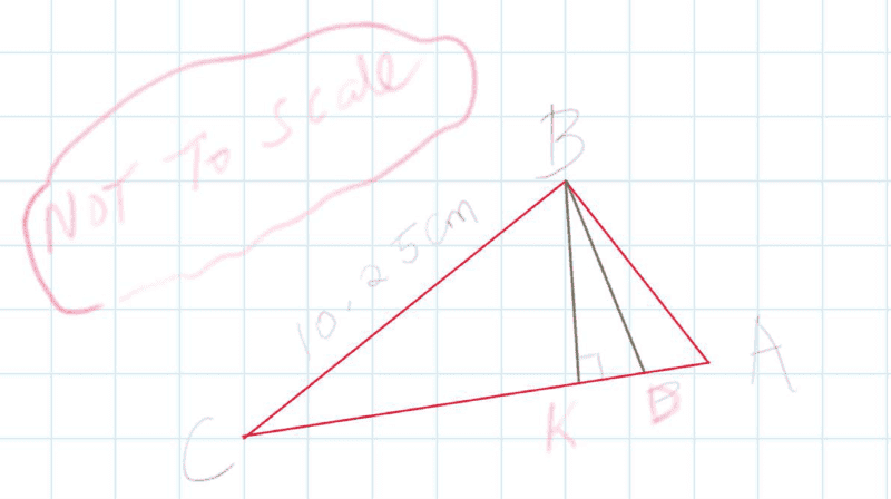

See attached ( kindly allow me to post as it is on exam script)
Understanding of the Triangle
My take:

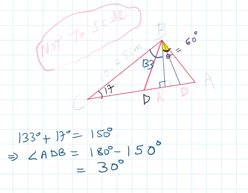

I got ##BC=10.25## cm, using cosine rule...no issue there. For part (b)
##BK=3cm## using sine rule i.e ##\sin 30^0 =\dfrac{BK}{6}##
Thus it follows that ##∠BDK=48.59^0## ...⇒##∠ADB=131.4^0## correct...any other approach?
Also:
##∠ADB=48.59^0## when BD is on the other side of the given perpendiculor line.
cheers guys

Seem ok to me.
'Not to scale' is an understatement....
And instead of outcomes, post steps: ##\angle ADB = \arcsin 3/4 = ...## is so much clearer !
##\LaTeX ## degrees is ^\circ : ##30^\circ##
