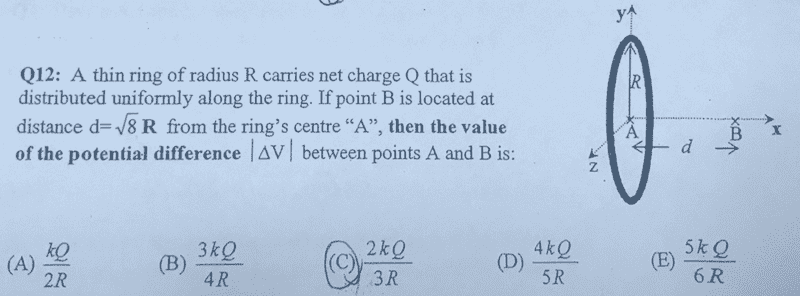

Find the potential difference between A and B

V = kq / r
VA = k q / rA
VB = k q / rB
rB = √((√8 * R)2 + R2)
= 3 R
VB = k q / 3R
ΔV = | VA - VB |
= | kq / R - Kq / 3R |
= 2 kq / 3 R
Can somebody check my answer please ?
Looks fine.
