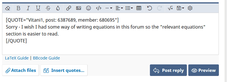

Vitani1 said:
Sorry - I wish I had some way of writing equations in this forum so the "relevant equations" section is easier to read.
See the "LaTeX Guide" link below the Edit/Reply window, or click INFO, Help at the top of the page. :smile:
Likes Vitani1
