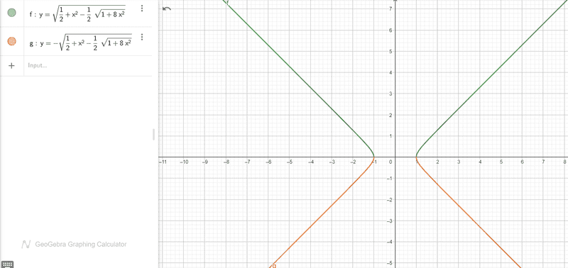

We know that ##-1 < \alpha < 1##, so I plotted the ##\omega## solution (y axis ##\omega##, x-axis ##\alpha##; I set ##\omega_p:= 1## for simplicity)
Mark44 said:
Note that due to the range of values for k, the graph should lie between the left- and right bounds for k shown above.
Mmm I am doing something wrong, because within the left- and right bounds for ##k## I get nothing...

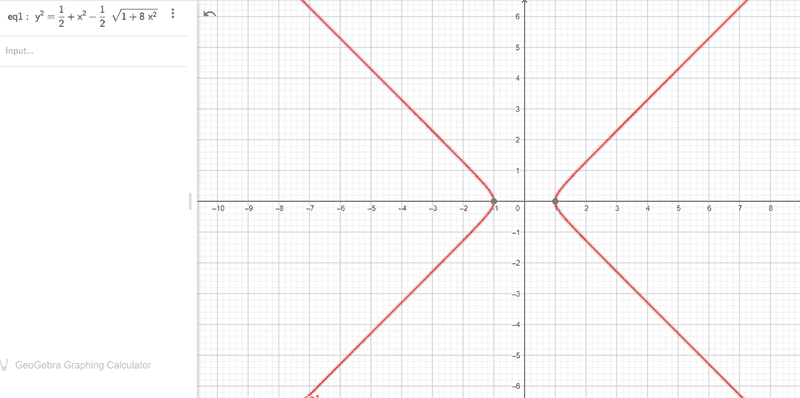

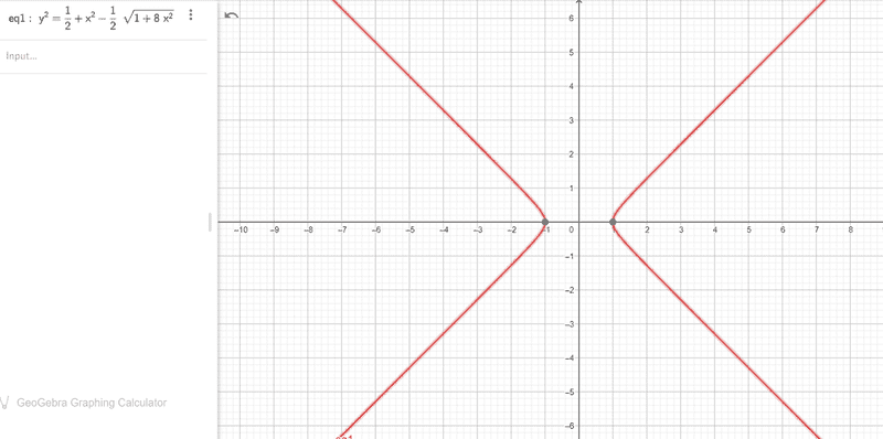

.This is what I get for the ##\omega^2## (vertical axis) vs. ##alpha## (horizontal axis) plot (with ##\omega_p:= 1##)
However, the hyperbolic behavior of the plot does not match your excel data...
Given that we are interested in plotting ##\text{Im}(\omega)## to eventually find ##k_{max}## and ##\text{Im}(\omega_{max})##, wouldn't be best to plot ##\omega## instead of ##\omega^2##? I would say that if we were to plot the former then ##\text{Im}(\omega)## would simply correspond to the ##-1 < \alpha < 1## range. Then, to find ##\text{Im}(\omega_{max})## we would just have to look at the maximum value of ##\omega## in that range and ##k_{max}## would be equivalent to find ##\alpha_{max}## (by definition of ##\alpha##).
Sure it does. In the spreadsheet I was interested only in values of ##\alpha## in the interval (-1, 1). For these values, the corresponding values of ##\omega^2## are negative, hence the values of ##\omega## are imaginary. Think back to the title you chose for this thread.
Do you see the following plot OK? (with the axis as mentioned)
Yes, I saw the plot in that post. The part between the two parts of the hyperbola is precisely the part where ##\omega## is imaginary, which is what you asked about at the start of this thread.
