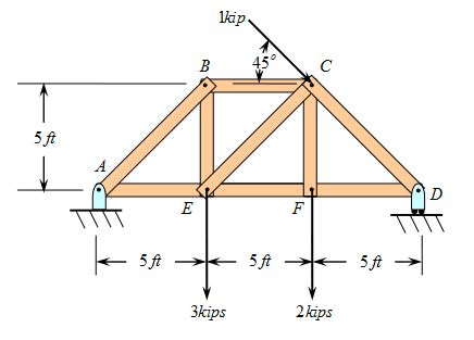

Find the reactions the pin A and roller D exert on the truss
In summary, the rigid truss is supporting various loads at pin A and roller D, while all concentrated loads act on the pins joining the truss members. The equation to find the reactions at pin A and roller D is ƩMa= -5ft(3kips)-10ft(2kips)-.707(1kip)10ft+Dy(15ft), with a solution of Dy=2.80 kips*ft. There should be no force applied at joint B, as the truss members only support axial loads. Additionally, the last two terms in the sum of moments about A equation are incorrect.

The rigid truss supports the loads shown. Find the reactions the pin A and roller D exert on the truss.
All concentrated loads act on the pins joining the truss members
Dy=2.80 kips*ft
My question is just regarding pin B. Am I supposed to assume some force is going down and to the left-45 degrees-at this location?

The truss members are supporting axial loads only.
And don't assume any loading at joint B, since there is no force applied there. Your last 2 terms in your sum of moments about A = 0 equation are also not correct.
