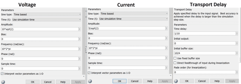

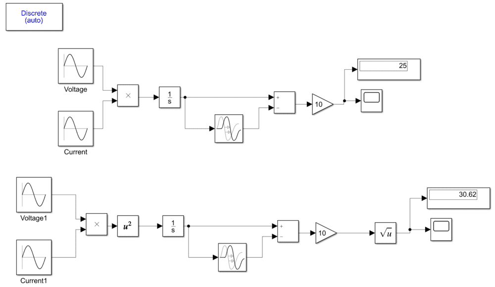

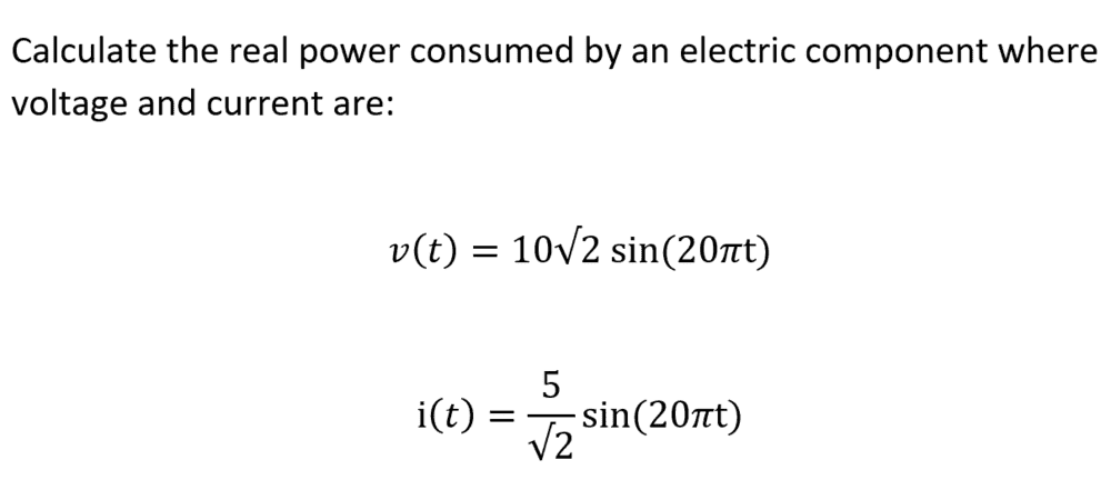

The question is attached below.
Output a sine wave:
O(t) = Amp*Sin(Freq*t+Phase) + Bias
T = 1/Freq
My work is attached below. I want to confirm my answer.
Any help would be greatly appreciated !

The DC and ac values that I got are :
P(dc)=25 W
P(ac)=30.62 W
I reattached the problem statement and my answer below.

There reeally is no need to attach them for the fourth time. I've seen all three in the first post already. The exercise is quite clear: you are supposed to
Calculate the real power consumed by an electric component where voltage and current are $$\begin {align*}
v(t) & = 10\sqrt 2 \sin (20\pi t) \\ \mathstrut \\ i(t) & = {5\over \sqrt 2} \sin (20\pi t)
\end{align*} $$
So, based on the first picture alone, I should think you need to find a definition of 'real power' and work out what it means in terms of the given ##v## and ##i## ...
I'm not familiar with your software package but I can guess what some of the blocks are supposed to do. (but about the function of the part in the middle
244918
I have no idea).
It's a transport delay which is equal to T (time=0.1 s).
Nothing to do with the question in this exercise, then !

"Find the real power consumed "
only needs algebra to derive the equation.

Instantaneous power P(t)=V(t)*I(t) has no real and imaginary parts. Real and Imaginary powers apply only to the average over a complete cycle. Calculate the RMS (root mean square) over a cycle.
There's no capacitor in the original problem statement, so why are you even talking about a capacitor? It seems to me that you're just throwing random things together to come up with an answer and hoping it's right. In the process, you're making this problem way too complicated.

look up the definition of real power.
Real power is produced when the current and the voltage are in phase with each other .
P in ac circuit = current(rms) * voltage (rms) * cos θ
P = current (rms) * voltage (rms) , (θ=0)
So, I have to find the rms values for current and voltage separately and multiply them together , right ?
You are given the expressions for ##v(t)## and ##i(t)##. What do they tell you about your ##\theta## ?
##\theta = 0## as I think you indicate.
That means that (according to e.g. https://www.allaboutcircuits.com/textbook/alternating-current/chpt-11/true-reactive-and-apparent-power/ ) true power
##P## is ##I^2R = V^2/R = V\,I ##.
With sine square averaging to 1/2 your Prms is indeed Vrms * Irms
