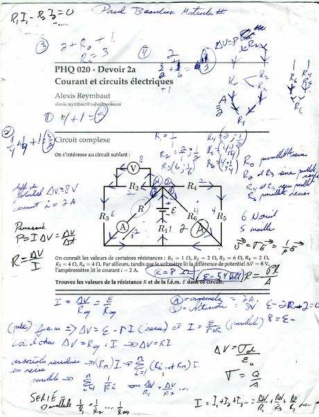

Find the resistance and EMF in a circuit
In summary: R2 and R3 are in series, so their total resistance is 8Ω.Since they're in parrallele with the unknow resistance, and we know the current at the junction where R3 and the unknown resistance meet,R2 and R3 are in series. So 8v = 8*i, so current after going through R2 and R3 is 1 amp.
thee qs
34
translation ; we know the values of
R1 = 1 ohm
R2= 2 ohm
R3= 6 ohm
R4= 2 ohm
R5= 4 ohm
R6= 4 ohm
we can also see the voltmeter reading a potential difference value of 8 volts , and the ampere meter giving a reading of 2 amps at the indicated locations
2. Relevant
[/B]
so , as you can see with the following attachements i ended up with value for the missing resitance of 8 ohm and a f.e.m ( electro force ) oh 54.
by plugging those in we get a potential difference of 8V and a 2 amp signal .
but i got those value by testing a real circuit, and can't get the same numbers through formulas. by symetry , shouldn't the right side have the same potential difference of 8 volts as the left side ?
pretty sure my resistance value of 8 ohm looks ok .
am i wrong in my calculations ? if my handwriting is too bad i can rewrite the equations here . we know the current coming in at a junction has to be the same as the current coming out.
since there are only resistance and only 1 battery , I am sure i already used the formula for the answer in one of my worksheet. . i know since i ended up with a value of 8R., gave me a hint that the missing R value was 8 .

I would find your handwritten working illegible even if I were fluent in French.
Please type in algebra, reserving images for diagrams and textbook extracts.
What is the current through R2?
What is the current through R3?
What is the potential drop across R3?
What is the potential drop across R?

potential drop and current across a resistance we get from R=delta V / i so
current = delta V / R
potential = R * i
R2 = 2 ohm
R3 = 6 ohm
so V= R2*i ---> 8 = 2*i ----> i = 8/2 = 4
current after R3 should be 2 amps because current after R is 2amps ,
no?
both are in series . but are in parallele with the unkown resistance R so the equivalent resitance for those 3 should be
2 + 6 = 8 ohm , then 1/8 + 1/R = the equivalent resistance value . same as ( 8 * R) / (8 + R ) = right side of circuit equivalent resistance .
