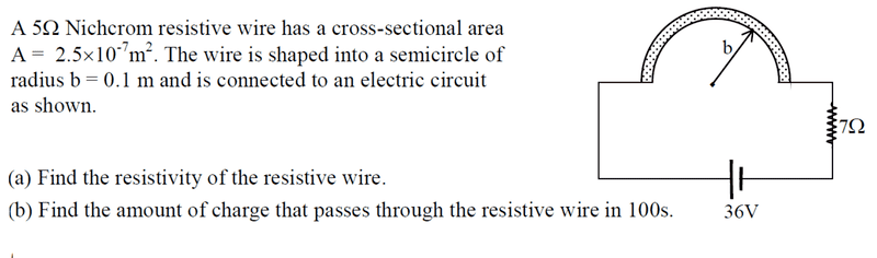

Find the resistivity of the resistive wire
In summary, the equation ##ρ=\frac{RA}{L}## is used to calculate the resistivity, and the equations ##I=\frac{ΔQ}{Δt}## and ##I=\frac{ΔV}{R}## are used to calculate current. The calculated values for resistivity, equivalent resistance, current, and charge are 3.978×10-6 Ωm, 12 Ω, 3 A, and 300 C respectively.
Fatima Hasan
319
##ρ=\frac{RA}{L}##
##I=\frac{ΔQ}{Δt}##
##I=\frac{ΔV}{R}##
(a)
##ρ=\frac{RA}{L}##
##L=\frac{2*π*r}{2} = πr##
ρ = (5*2.5*10-7)/(π*0.1)
ρ = 4*10-6 Ωm.
(b)
Req = 7+5 = 12Ω
##I=\frac{ΔV}{R}##
I = 36/12 = 3 A
##I=\frac{ΔQ}{Δt}##
3 = ΔQ / 100
ΔQ = 3*100 = 300 C
Is my answer correct ?

Yes, but the resistivity comes out to be 3.978×10-6 ohm-meter. You might not get full credit if you round that off to 4.
