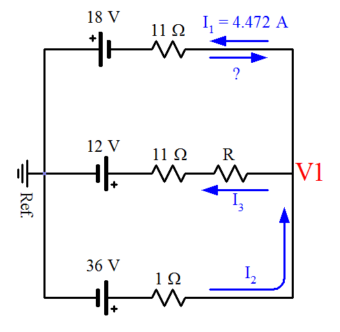

In the circuit shown, what must be the size of the resistor R such that the power delivered to the 8 Ω resistoris 160 Watts?
Circuit is in the first image

Bit of a tricky question here. I agree with your determination of the required current through the 8 Ω resistor in order for it to dissipate the required 160 W. But knowing the power dissipated by a resistor doesn't tell you which direction the current flows through it, so you have to test both cases to see which will produce plausible results.
What I suggest is that you simplify the circuit a bit by gathering up known resistors where possible to begin with, and add a convenient reference node:
Then use the given information about the branch with the "known" current to determine the potential at the V1 node with respect to the reference node One value will be plausible when you consider the constituents of the other branches, the other not so much (without invoking some exotic characteristics for R). What value will you choose for V1?
Hint: The highest potential source in the circuit is the 36 V source. Being the highest source, you can be sure that any current from it must flow out of its positive terminal (again, unless exotic characteristics are invoked for R).

The order of the components in a given branch doesn't matter. I chose to "move" the resistor for purely aesthetic reasons, making the image easier on the eye. Adding up potential drops in series is much like adding up several numbers; the order that you sum them doesn't affect the total.

Yes, if you want to choose directions for your currents then you can make a judgement call about about what influence you think the circuit's emfs will have. But I should point out that there's really no "wrong" choice; the math will eventually take care of the sign of the current regardless.
I pointed out that the current direction in the bottom branch is constrained by it containing the largest voltage source inn the circuit, and you should be able to work out what the direction of the current must be in the top branch from the resulting potential it forces at V1. That leaves the middle branch as an unknown, but should become obvious once the other two currents are calculated.
Ok, thanks for the help! Really, this has been an eye opening experience here! So I did the problem using I1 going both ways. With the I1 going towards, I got a positive R, but its kind of big. With the I1 going away, I got a negative R, and an I that is over 100 A, so I think that is wrong.

I get about 46.4 Ω .
Me, too. The node at V1 is 31.2 volts above the reference level (ground).
