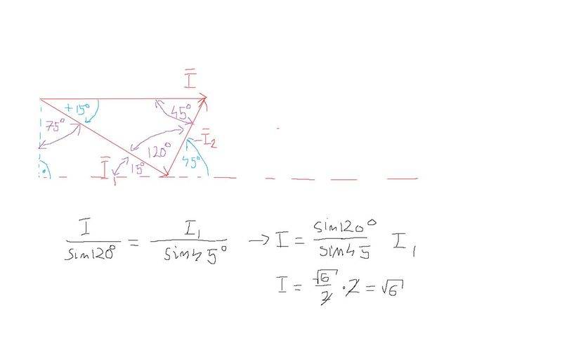

In the network of sinusoidal current, as shown in the figure, the current i2
is phase delayed for the angle of 3π/4 behind the current i.
In the moments in which the current i2 is minimal,
current value of current i1 is sqrt(2) A. This value is two times lower than the maximum
value of the current i1, and in those moments current i1
and growing.
Calculate the effective value of the current I.
Captureelektrijada.jpg[/PLAIN]

Is there any way to find the angle Φ2 since I know that in the moments when i2 is minimal value of the current i1 is sqrt(2)?

I tried to solve it this way now:
i = Imax *sin(wt)
i1 = I1max *sin(wt + ψ1)
i2 = I2max *sin(wt+ 3*pi/4 )
at time t = t1 when current i2 is minimal.
-I2max = I2max * sin(w*t1 + 3*pi/4) -------> wt1 = -5*pi /4
2*i(t1) = I1max ------> I1max = 2*sqrt(2)
sqrt(2) = 2sqrt(2) * sin (w*t2 + ψ1) / arcsin
ψ1 = 17*pi / 12
which is incorrect the the correct phase delay of the current i1 is ψ1 = 45°

i2 is delayed, so phase should be negative.

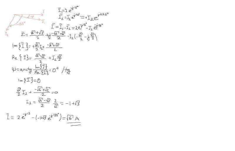

Tried calculations now with negative sign of ψ2 = -3π/ 4 and the result that I got is ψ1 = -π / 12 , which gives ψ1 - ψ2 = 2π/3 as it is correct.Now need to figure out how to find RMS value of the current I.
Got the right solution now:
Their solution
How did they get this expression ? It looks way simpler than my approach.
Looks like they applied The Sine Rule. The 3 currents form a closed triangle.

Yes you are right
Thank you for your help.
