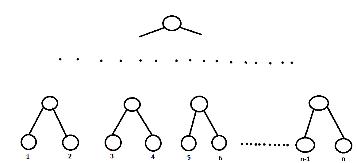

Build a tournament tree by first pairing the $n$ elements together, and the smaller element of the pair advances to the next round of the tournament. This will yield a binary tree of height $\left\lceil{\log_2 n}\right\rceil$.
Also, the number of comparisons needed to create this tree would be defined by the recurrence $T(n) = T(n/2) + \frac n2$, and $T(1)=0$. because at each round, we do $\frac n2$ comparisons and move onto the next round. That recurrence has a solution of $T(n) = n - 1$.
After $n-1$ comparisons to build the tree, we know the root of the tree (the winner) is the smallest element. All we need now is to go to each depth of the tree and find out the element that the winner beats. There will be $\left\lceil{\log_2 n}\right\rceil$, we can find the minimum of this set with $\left\lceil{\log_2 n}\right\rceil - 1$ comparisons (linear scan).
Total number of comparisons is $n-1 + \left\lceil{\log_2 n}\right\rceil - 1$.

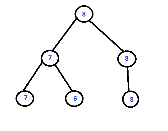

I like Serena said:
Now suppose we have $m$ candidates for number two.
Then we can create a new tournament tree, for which we already know that we need $m-1$ comparisons.
So,is it like that? (Thinking)
Yep. That's the tree for second best.
So it takes 2 comparisons. (Smile)
(Nod)

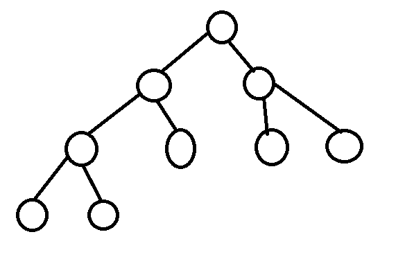

So, is it of this form, for $n=8$? (Thinking)
If so,why do we need one more level for $n=9$ ? (Thinking)
evinda said:
So, is it of this form, for $n=4$? (Thinking)
That tree has $n=5$ leaves... :confused:
So it has one level more than a tree with $n=4$ leaves.
Oh yes,right! (Blush)
So, is it like that? Or have I done something wrong? (Thinking)

A ok... So, if at the beggining, $n$ is equal to an odd number,for example, $9$, is it then like that?
I like Serena said:
Right! (Nod)That brings us to how many candidates we have for second place. (Thinking)
And finally how many comparisons we need in total. (Thinking)
So, in order to find the first place, we need $n-1$ comparisons and then, in order to find the second place, we need $\lceil \lg n \rceil+1-1= \lceil \lg n \rceil$ comparisons.
Therefore, we need in total $n+ \lceil \lg n \rceil -1$ comparisons, right? (Thinking)
But..the exercise asks to show that we need $n+ \lceil \lg n \rceil−2$ comparisons... :eek:

It is not a complete binary tree, but yes, we can also do it like that.
Let's do this carefully to avoid any plus-or-minus-one mistakes. (Worried)
Take a look at our tree with $n=8$ leaves.
It has $\lceil \lg n \rceil + 1 = 4$ levels yes?
How many candidates for second place does that make?
Is it the same or is it different? (Wondering)

So, when we have $n$ elements, the tournament tree is of this form:
and we suppose that we need $n+ \lceil \lg n \rceil-2$ comparisons, in order to find the second smallest element.
But.. what do we do, when we add the $(n+1)^{th}$ element, to show that in this case we need $n+1+ \lceil \lg{ (n+1) } \rceil-2=n+ \lceil \lg{ (n+1) } \rceil-1$ comparisons, for the finding of the second smallest element? (Thinking) (Sweating)

In the first case we have a tournament tree that is not a full binary tree, but only a complete binary tree.
When we add leaf $(n+1)$, we need $1$ more comparison to find first place.
Since the tree was not a full binary tree yet, the number of levels stays the same.
Therefore the (worst case) number of comparisons for second place also stays the same.
Therefore the formula $(n+1) + \lceil \lg{ (n+1) } \rceil - 2$ is satisfied. (Wait)

For $n=9$, we have, for example, this tournament tree, right?
Why is it a complete binary tree, but not a full one? (Thinking)

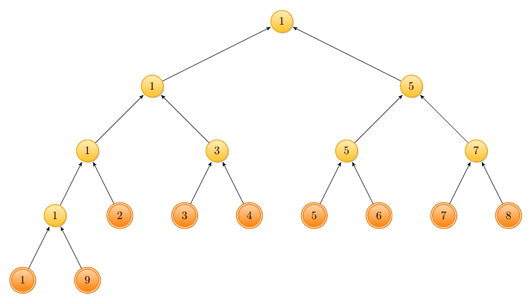

It is neither, because node $\enclose{circle}9$ is really at level 2 instead of on the last level. :eek:
The complete binary tree is:
And it's not a full binary tree since the last level is not fully occupied. (Shake)

So, do we have to compare the $(n+1)^{th}$ element with the smallest, that we found, when we had $n$ elements?
If so, then if it is greater, then we need one comparison, right? :confused:
And.. if it is smaller than the smallest that we found, do we need again only one comparison, since the new smaller element gets the position of the previous one? (Thinking)

I may have gone overboard when creating the tree. (Blush)
It's not supposed to be sorted.
It was just easiest to do it that way.
We just need to slide element $(n+1)$ in somewhere so that we still have a complete binary tree.
That is always possible and will take exactly $1$ more comparison to figure out number one.
