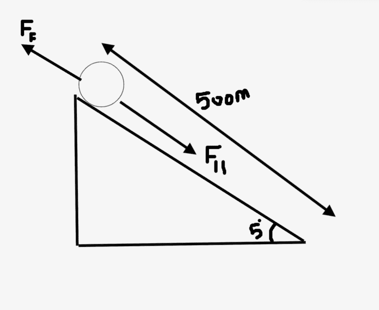

A biker and his bike have a combined mass of 90kg. The rider starts from rest and rolls(no pedalling) down an incline that is 500m long. The plane is at an incline of 5 degrees above the horizontal. The average frictional force acting on the bike/rider is equal to 60N. Find the speed of the biker at the bottom of the hill.
Net work done on a system = change in K.E
I used the work-energy equation to solve this problem.Only the parallel component of force acts to accelerate the biker and increases K.E., so only the parallel component and frictional force does work on the biker.
therefore,
$$(F_I{_I} + F_F) d cos\theta = \frac{1}{2} m\cdot v_f^2$$
$$ (mg sin\theta \cdot d cos\theta) + (F_F d cos\theta) = \frac{1}{2} m\cdot v_f^2$$
$$ (90 \cdot 10 \cdot sin 5 \cdot 500 \cdot cos0) + (60 \cdot 500 \cdot cos 180) = \frac{1}{2} m\cdot v_f^2$$
$$ v_f = 14.31 \frac{m}{s}$$
where, ##cos 0## - angle between the force and the displacement, where the parallel component of force is in the direction of motion and ##cos180## - angle between the frictional force and the displacement, ##v_i =0##
I know something is not right in the above equations that I solved. I didn't include GPE which should give me a different set of equations, and I didn’t use that approach; I'm just confused. Any help would be greatly appreciated.

Now the frictional force is already along the motion, you should not include any angles there.
Why are you even using ## \cos \theta ##? You should view this is a one-dimensional problem. You already have the lenght of the incline which is the distance travelled by the bike.

Yeah, you're right. But still, do I get the same answer? I don't think so

It's funny how many question setters think friction acts on a rolling wheel! It should be rolling resistance. The main thing, however, that would slow a bicycle going downhill would be air resistance.
This is not quite right, as you have not treated the slope correctly. If a slope is ##500 \ m## long, then it's ##500 \ m## long. It's not ##500 \cos \theta \ m## long.

$$(F_\parallel - F_F) d = \frac{1}{2} m\cdot v_f^2$$
$$ (mg sin\theta \cdot d ) - (F_F d) = \frac{1}{2} m\cdot v_f^2$$
$$ (90 \cdot 10 \cdot sin 5 \cdot 500 ) - (60 \cdot 500) = \frac{1}{2} m\cdot v_f^2$$
I'm confused about whether the force of friction is negative in the above equation, because the net work done is adding the work done by the individual forces, and since it's a scalar quantity, do sign conventions matter here?
paulimerci said:
. . . and since it's a scalar quantity, do sign conventions matter here?
Are you suggesting that scalars can only be positive? There are no sign conventions in this particular case. The work done by a force on an object is (as you know) $$W=F~d~\cos\!\theta.$$ Here

Well, putting a ##+## sign in front of the friction term adds to total available energy to be converted to kinetic energy. Does that sound correct to you?

Friction (rolling resistance) must be up the slope, acting against motion down the slope.

Okay, so the answer would be ##v_f = 14 \ m/s

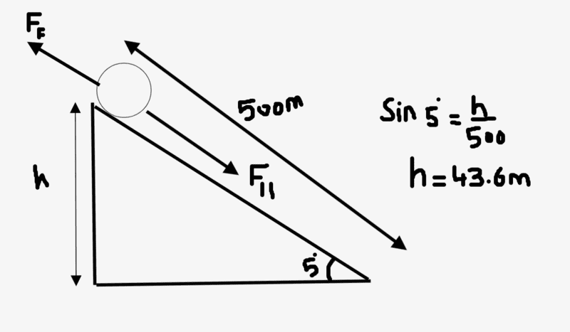

At the top of the hill, the biker has a maximum GPE, and when there is no friction involved, GPE is transformed into K.E. But in this case frictional force is doing negative work which takes away some of the GPE. Using the law of conservation of energy,
Total energy initial = Total energy final
$$ mgh = \frac{1}{2}mv^2 + W_F $$
$$mgh - F_F \cdot d \cos \theta = \frac {1}{2}mv_f^2$$
##\theta = 180## which will add the energies on the LHS of the equation, which should not be the case.

When using that you have to apply some interpretation and intuition.
For this "mechanical energy robbing" process, the LHS is ALL the energy you have available. The RHS represents all the bins that energy gets split up into. So indeed, it is not consistent with the strict\formal definition of work as it appeared above.
I don't know why I don't see this in my intro physics textbook, but maybe all we need to be consistent with the definition of work would be to change the sign to a negative on the original equation
$$ U_o + KE_o + PE_o = U_f + KE_f + PE_f - \int \mathbf{\vec{F_{nc}}} \cdot d \mathscr{ \vec{ l }}$$
Like I said, I don't apply it like that, I always just "think about it" for a given situation and hopefully apply appropriate sign to the ##W_{nc}## term. The textbook actually suggests that approach too. Maybe a minus sign on that last term runs into issues somewhere else I'm not seeing currently, maybe they thought it more simple to remember with all ##+##'s in the equation. The Physicist's will probably speak to this better.
I think one needs to be clear what system one is using here and whether that system is open or closed. Invoking mechanical energy conservation is inappropriate because ##K+U## is not conserved since there is friction. That leaves (I) the work energy theorem and (II) total energy conservation.
Case I
Assume that the system is the cyclist and bicycle. There are two entities doing external work on this system, the Earth and the whatever provides this "average" force of friction. Then the work energy theorem says $$\begin{align} & \Delta K=W_{\!g}+W_{\!f} \nonumber \\ &\frac{1}{2}mv_{\!f}^2-0=m~g~d\sin\!\theta-F_F ~d.\nonumber \end{align}$$Case II
Assume that the system is the cyclist + bicycle + Earth and that this is an isolated system, i.e. no external entities do work on it. Conservation of total energy is expressed as ##\Delta E_{\text{tot}}=0.## We have to account for the energy transformations within the system. These are the changes in kinetic and potential energy as well as changes in thermal energy due to friction. Specifically, the work done by friction ##W_{\!f}## appears as an increase of the thermal energy of the system, cyclist and bicycle warm up and the air molecules around them moves faster on average. We write ##\Delta E_{\text{therm}}=-W_{\!f}=F_F~d.## Then by the principle of total energy conservation, $$0=\Delta E_{\text{tot}}=\Delta K + \Delta U_{\!g}+\Delta E_{\text{therm}}=\left(\frac{1}{2}mv_{\!f}^2 -0\right)+(0-m~g~d\sin\!\theta)+F_F~d.$$The equations say the same thing, but the terms in them are shifted around because the energy accounting is different.

Thank you for the detailed explanation. In in the above statement
##\Delta E_{\text{therm}}=-W_{\!f}=F_F~d.## why it's not ##-W_{\!f} = -F_F~d##? Did you take the angle between the frictional force vector and the displacement vector as ##180 ##?

What, exactly, is ##F_F## in your view? In my view, it is an unsigned scalar specified as being 60 N. It is the magnitude of the frictional force between bicycle and ramp.
We need not concern ourselves over much with the direction of either force or displacement. We should intuitively realize that the net work done by the frictional force between two objects within a single system will always be negative. For the sorts of surfaces one encounters in first year physics, the force will always be anti-parallel to the slip direction This means that we can be quite casual about sign conventions. We can multiply the magnitude of the force pair by the magnitude of the displacement, negate the result and call it a day:$$W_f = - F_F\ d$$
Clearly, thermal energy will be created by the friction. The change will be positive. If we are multiplying +60 N by +500 m we do not want to obtain a negative result.
[I trust the idea that my hands get warm when I rub them together a lot more than I trust myself to get all of the sign conventions right when deduce the same result from a vector equation].
There are several ways to solve this problem. Using GPE is one, but not the only one.
You said there were other ways to solve this problem. What are those?
  • #31
Uniform acceleration; energy is net force times distance; GPE + friction.

I would like to do the problem again, which I posted in #1.
I will take ##\theta## as the angle of incline and ## \phi## as the angle between the force and displacement vectors. I'm using the work energy theorem to solve for the velocity of the biker at the bottom of the hill.
$$ F_\parallel \cdot d cos \phi + F_F \cdot d cos\phi = \frac {1}{2}mv_f^2$$
##\phi## for the first term is zero because the force parallel is along the direction of motion, and ##\phi## for the second term is 180 because the force of friction is opposite to the direction of motion.
$$ mgd sin \theta - F_F \cdot d = \frac{1}{2}mv_f^2$$
$$v_f = 13.7 \frac{m}{s}$$
I did the same thing, but this time I defined what angles I was using and wanted to check whether I did it right this time.
Thanks! I'll give it a try on each of them. I think I did the last one, and I made a few mistakes there.
  • #34
I tried the first two methods, and I'm getting the correct answer. I don't know how to do the last one.
  • #35
The kinetic energy of the bicycle at the bottom of the slope equals the gravitational potential energy lost minus the energy lost to friction.
If you do all three methods algebraically, you should see more clearly how they all ultimately involve the same mathematical calculations, just with the key expressions and equations presented differently.
