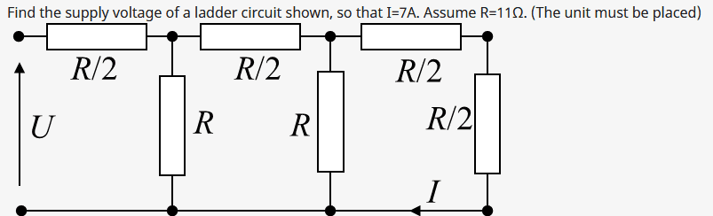

Find the supply voltage of a ladder circuit shown, so that I=7A. Assume R=11Ω. (The unit must be placed)
Hello, everyone. Please, help me with this. Could someone explain to me how to solve such tasks. I literally spent the whole day watching Khan Academy and trying to figure out how to solve these circuits, but still, I can't do a thing. I would also be very glad if someone shared a link to some article about this, I have to solve an awful lot of such tasks and I really need to learn how to deal with them. ASAP

Welcome to PF.:smile:
In this problem you can just use a few combinations of series and parallel resistors to fold up the circuit from right-to-left. You will be left with only one resistor across the power supply, which will let you solve for the value of R to give the total input current of 7A.
So, are the right-most two resistors in series or in parallel? What is the resistance value that you get when you combine them? And then look to the next resistor to the left, and figure out how to combine that into the previous combination resistance. And so on, until you are left with just the one resistor.

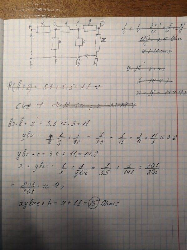

Okay, so my algorithm was: 1) Those 3 resistors in the top are in series, hence their overall resistance is 16.5 Ohms; 2) the Other 3 resistors are in parallel, (1/11) + (1/11) + (1/5.5) = 11/4 = 2.75; 3) I have 2 resistors in series left, therefore 16.5 + 2.75 = 19.25; 4) V = IR = 7 * 19.25 = 134.75V; Unfortunately, I know that this is wrong, because I failed this( Could you please correct my thoughts?

Isn't I=7A the current through the bottom-right branch?
@propvgvnda, I believe you need to use series-parallel reduction technique along with KCL and KVL to find the equivalent resistance and total input current.
Based on these two, you can compute the input voltage U.

Well, if I is the current through the right-most two resistors, that gives you the node voltage at the top of them. That voltage is across the next R to the left, which tells you what its current is. Just keep walking to the left using that technique to see what input voltage it takes to support all of those currents.
Overlapping possibly or equivalent to whait others have said:

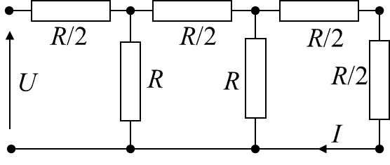

Label the nodes in the top row A, B, C, D, and in the bottom row E, F, G, H.
What is the total resistance between C and H?
Redraw The diagram with that as a single resistance between C and H, or, same thing, an additional resistance between C and G.
Now what is the total resistance between G and H?
Then condense the thing in the same fashion so that you get the total resistance between A and F (same thing as A-E).
You then have the total resistance of the circuit, you are given the voltage, so you can work out the total current.
The total current goes through AB, you can work out the voltage drop across that. Then work backwards, maybeYou don't have to work out the voltages and currents in every single branch, but don't worry about being maximally efficient, just get the result even if you have to get every single current and voltage - such refinements can come later, you may think of some as you go along.
Use R all through and only convert to a number at the end.
The current being asked is H → G according to the arrow on the diagram. Which is the same as...
Hope it will be evident or will become evident to you that that makes sense for how to do it

The rightmost vertical and horizontal R/2 are in series, so can be collapsed into a single resistance, but between two adjacent R/2 resistors in the top line there are other connections, so more current may flow through one of these resistors than another.
Similarly, the rightmost R and the rightmost (vertical) R/2, though parallel, do not share the same voltage because of the rightmost R/2 in the top row.

Hello. I was using your method and I got overall resistance of approximately 15 Ohms. Is that right?
No.
Please show your work so we can see what went wrong.

As per your diagram, b+z= 11 ohm.
This 11 ohm is in parallel with c..and so on.
Keep reducing the circuit this way until you have only one resistor left.
...and then when I have bzc it's in series with y right? and so on?
Yes.
I think there is a mistake in your second line where you are treating a series connection as a parallel one.That you have made it rather more difficult for yourself and us by introducing an extra notation when all resistances, currents and voltages can be sufficiently specified by the nodes A-F. Admittedly you could then have ambiguity between the resistance in a branch e.g. CG and the total or effective or equivalent resistance of the circuit between C and G which we might call simply (RCG)tot. This is in fact what you need to obtain in your second step, and I believe you would not have made the mistake you have if you had redrawn the diagram at that stage as recommended - you do not seem practised enough to do this in your head yet. And it would be simple for yourself and others if you kept R up to the point where you work out the total current (IAB = IEF).
If you redraw and label the equivalent resistances at this and the next stage you might then also just be able to conclude immediately and work backwards in your head to IHG (= ICDHG) because of the rather simple way the current is splitting at each junction.

Yes the total resistance of the circuit is just R, (=11Ω) , so looking you have calculated right. I didn't ask you to digest information, just to redraw a diagram with the equivalent resistance RCDH you found, well almost, by the calculation
RCD + RDHG = R/2 + R/2 = R .
If you had done that it would have been obvious you then had a pair of resistances in parallel whose equivalent resistance you can also calculate and then do another new diagram.Would then be evident you then have the same thing again. And it would now be evident that the voltage AF and the current at each node split in a very simple way and the answer to the problem would be immediately obvious.

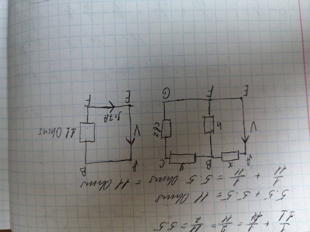

I tried to redraw it. Got this

You can find the V marked on your diagram (the voltage across CG) from the given current and resistances. From that, you can find the current in CG, etc.
  • #34
You know the total resistance of the circuit which turns out to be simply R (=11 Ω) .
If you knew the total current IAB (=IFE) required you would easily find the voltage VAE.
You don't yet know the total current required you only know that required in branch HG. You would know that total if you knew the proportions in which the current splits at each junction.
That would be obvious if you did the diagrams completely.
If we call the original circuit Fig.1, then you have now done Figs. 3 and 5. Missing are Figs. 2 and 4 where you have summed the series pairs into a single equivalent resistance. On each diagram you should write the equivalent resistance of each element, far preferably in terms of R, and the letters for nodes.
If it seem to you an extravagrant labour to do four diagrams, I think if you did that it would become quite obvious to you how currents, and for that matter voltages, divide themselves at each junction, which would be better than making such slow progress.

I think the answer is 77 V
