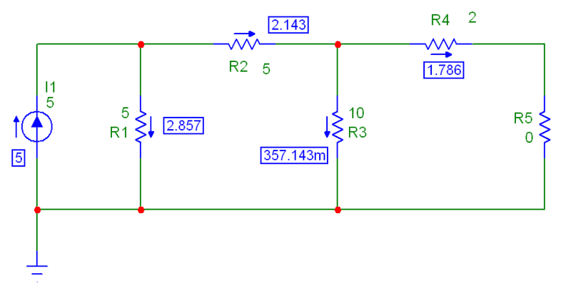

These are the currents at RL=0 as calculated by a simulation program;
the "Thevenin current" is 1.786A ( to be then multiplied by 70/17 Ω).
( 357.143m = 0.357143A )
AlexCaledin said:
These are the currents at RL=0 as calculated by a simulation program; the Thevenin current is 1.786A, to be multiplied by 70/17 Ω.
The current in a series circuit is everywhere the same , why I2 doesn't equal to I1 ?
Why is it series?
5 amperes are rather applied to parallel resistors:
one is the R1 = 5ohm and the other is {R2 + R3-and-R4} = 5 + 20/12 = 40/6 = 6.66666etc ohm;
so in the R2 there is less current.

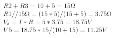

That's good. Now calculate V5 with the R1, R2, R3 combination load.
Fatima Hasan said:
You have correctly calculated the voltage V5 across the current source, which is also the voltage across R1. Your last calculation is wrong. You should be calculating the voltage V3 across the resistor R3. You have labeled the left side of that equation V5, but it should be V3, which is also Vth.
If you know the voltage at the left end of R2, which is V5, then what would be the voltage at the right end of R2 considering that R2 and R3 form a voltage divider?
V2 = R2 /(R1+R2)*Vs
= 5/(10+5) * 18.75
= 6.25 V
Fatima Hasan said:
V2 = R2 /(R1+R2)*Vs
= 5/(10+5) * 18.75
= 6.25 V
I'm not sure why you would want the voltage across R2 (which we would call V2). Vth is the same as V3 which is the voltage across R3.
If you replace the current source and R1 with an 18.75 volt battery, could you calculate the voltage across R3? If all you had was a circuit with an 18.75 volt battery on the left side, with R2 and R3 forming a voltage divider, what would be the voltage across R3?
V3 = 10/15*18.75 = 12.5 V
Congratulations! This is correct. You now have Rth and Vth. Do you understand all the steps now?

R4 and R3 in parallel --> R* = 2*10/(2+10) = 5/3Ω
R* and R2 in series --> R total = 5/3 +5 = 20/3Ω
I1 = R total / (R total + R 1)* is
I1 = (20/3) / ((20/3)+5) * 5 = 2.857 A
Is = I1 + I2
I2 = 5 - 2.857 = 2.143 A
  • #32
We got the value of 6.25 volts across R2 with RL removed. If RL is not there then R3 and R4 are not in parallel; R3 and R4 are only in parallel if RL is replaced with a short. You are trying to compare the voltage across R2 with RL removed to the voltage across R2 with RL replaced with a short. You can't expect the voltage in the two cases to be the same.
Likes Fatima Hasan
