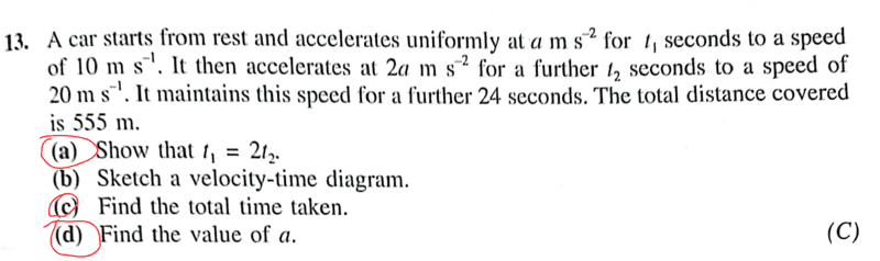

Kindly see attached; interest only on parts;
a, c and d
Kinematics equations
This is the question; I made some math error...then i just realised this is an easy problem...anyway, i know you guys may have an alternative approach to this; kindly share...
For part (a) i have;
##a=\dfrac{10}{t_1}## and ##2a=\dfrac{20-10}{(t_1+t_2)-t_1}##
##⇒\dfrac{10}{t_1}=\dfrac{10}{2t_2}##
##t_1=2t_2##
For part (c); i have
##A_{total}= A_1+A_2+A_3##
where
##A_1=\dfrac{1}{2} × t_1 × 10##
##A_2=\dfrac{1}{2} × t_2 × (20+10)##
##A_3= 24 × 20##
##555=10t_2+15t_2+480##
##75=25t_2##
##t_2=3## seconds
##t_{total}=6+3+24=33##seconds
For part (d),
##a=\dfrac{10}{3}=3\frac{1}{3} m/s^2##
Cheers! Bingo!

Yes, there does appear to be some math error.
I see that you skipped part (b), but the title of the thread,
"Solve the given problem involving the velocity-time graph",
does promise a graph.

part (b) is fine with me...i was interested on the highlighted part. I amended the thread title...

I agree with a and c.
But I think in part d you've made a mistake.
You said a=10/t1 so a should be equal to 10/6.
