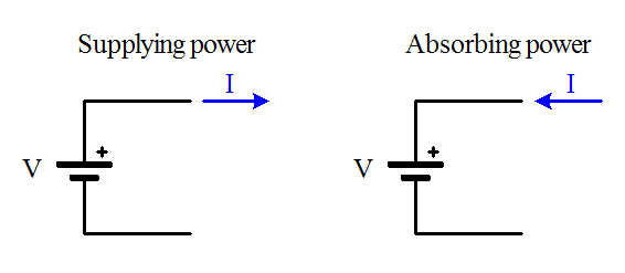

The capacitors supplied energy while the source absorbed energy.
Likes doktorwho
So the ##q## flows from - to + and it then absorbs it and if the voltage source was reversed it would supply it?
So if the q flows into - it supplys and revesed ot absorbs?
For example if the q was -30 and it was shown in orig picture to go into + of V it would mean that it supply's because the q is negative and it actually flows to the -?
That's the idea. Pictorially:
