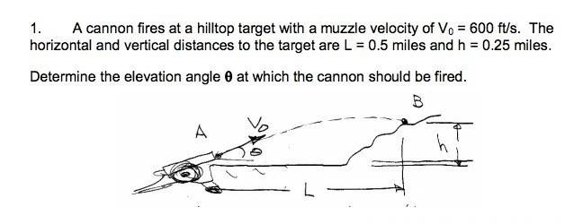

A cannon fires at a hilltop target with a muzzle velocity of V = 600 ft/s. The
horizontal and vertical distances to the target are L = 0.5 miles and h = 0.25 miles.
Determine the elevation angle at which the cannon should be fired.
L=2640 ft
h=1320 ft
2θ=arcsin([g*R]/V^2)
2θ=asin([32.2*2640]/360000)
2θ=asin(.2361)
θ=6.8282
This would be the correct angle if the cannon ball were to hit the ground, but the ball is landing on the hilltop. What equation should be used to include the quarter mile in the air?

Use the general formula for the projectile.
h = xtanθ - 0.5gx2/v2cos2θ and solve for θ.
