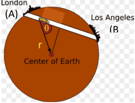

The train will use gravity to traverse from point A to B, in your answer, use the gravitational constant g and R - the radius of the earth in your answer. Assume the earth's mass is uniform
##L = T-V, KE(0) = 0, PE(0) = KE + PE##

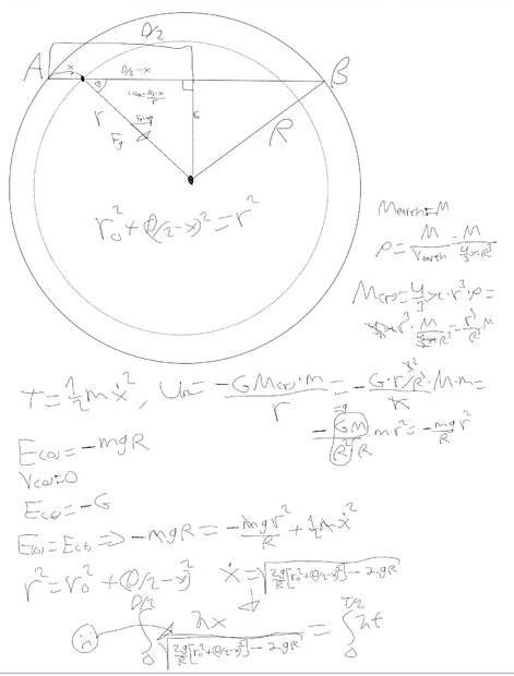

I need to find the transit time of the train, from what I see online it should be independent of points A and B and should be roughly 42 minutes.
I started by looking at the energies and derived an ODE for the speed of the train to find the transit time but it seems to be wrong.
Also, I might need to use the Lagrangian since we learned it in the last lesson.
##M_earth := M##
##\rho = M/4/3 * \pi * R^3##
##M(r) = r^3/R^3 * M##
##T = 1/2 * m *(dx/dt)^2##
##U(0) = -mgR##
##U(r) = -mg/R *r^2##

The Lagrangian approach works quite well. But, you must be careful calculating the GPE inside a solid sphere. Your expression for ##U(r)## is not correct.

Please calculate the gravitational force, as a function of ##r##, based on your potential.
Oh I think it needs to be ##U(r) = -mgr^2 / 2R##
Because the force is ##G*M(r)*m/r^2 = mgr/R## and integrating this with a minus sign gives ##-mgr^2 / 2R## but I still get a wrong solution

I start by deriving the potential given the aforementioned force ##F=-G*M(r)*m/r^2 = -mgr/R => U(r) = mgr^2/2R##
Now there is no kinetic energy at time 0 so the total energy at time zero is ##E(0) = U(r=R) = mgR/2##
From conservation of energy:
##mgR/2 = m*v^2/2 + mgr^2/2R##
now I can use the Pythagoras theorem to show that ##r^2 = r_0^2 + (D/2 - x)^2## problem is I don't have an easy way to express r_0 (I can use trigonometry but it gets messy) and after I figure out an expression for r using x I can generate an ODE for dx/dt (v) and find the transit time. How can I continue from here? I'm stuck

I thought you were going for the Lagrangian approach?
In any case, you could try looking for the equation of motion for the horizontal displacement. The trig is fairly straightforward.
update: using trigonometry worked but it is kinda dirty (sin of arccos) but it gave me the correct expression

is there a nicer way to express r^2 using x? because I get ##r^2 = r_0^2 + (D/2 - x)^2## and ##r_0 = R*sin(arccos(D/(2*R)))##
I just expressed everything in terms of ##x##.

I asked the question too quickly but it doesn't matter since r_0 is still a constant and thus "disappears" in the E.L. equation
