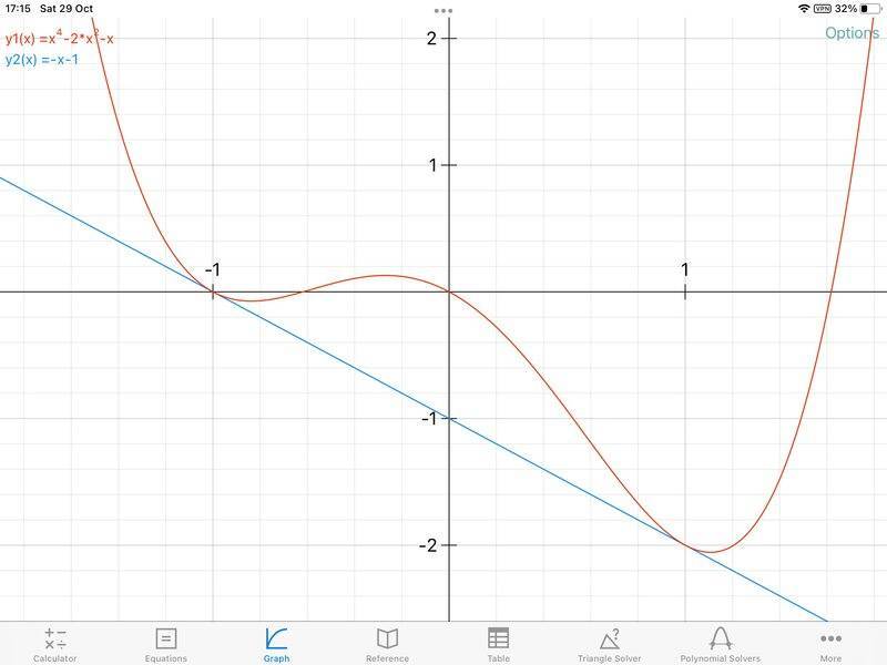

I thought I was fairly well up in polynomials, for an amateur, and that this would be a doddle. Instead I found it quite difficult, maybe the operative word there is 'was'. :oldcry: .
I didn't go through the OP's calculations, they looked too heavy and complicated. When it gets that complicated one should look for a simpler approach.
But then I realize that is even when true easier said than done sometimes. especially if you had a method which you are sure should work, so if it doesn't you might think there is some calculational error and ask for help as the OP did.
I know how to find the condition for a double root of a polynomial, I do not know a formulation for finding two double roots any more compact than finding one and then the other.
Anyway I eventually found (independently) essentially the same formulation as that of pasmith, and it all falls out in a couple of lines, with result ##m = -1, c=-1##. You do not even need to consider the derivative. So I can only add, seeing is believing:
I'll worry about how general this is some other time.
