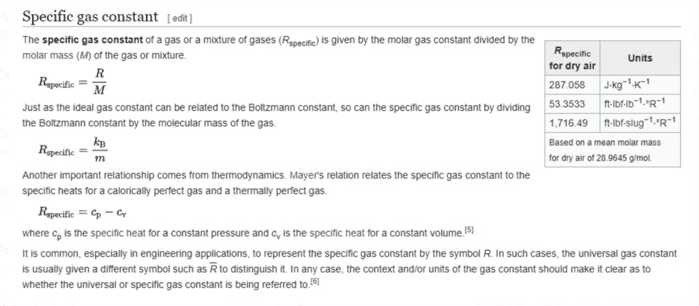

I saw this on Wikipedia, where it mentions that Rspecific = Cp -Cv. Is there something that I am misunderstanding?
Thank you.
You can express heat capacities per unit mole or per unit mass. The same goes for the gas constant. The gas constant per mole is the universal gas constant.
Likes Kajan thana
