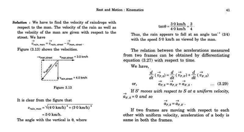

Q. A man is walking on a level road at a speed of 3.0 km/h. Raindrops fall vertically at a speed of 4.0 km/h. Find the velocity of the raindrops with respect to the man,
A. The explanation is below:
Here I don't understand the diagram. Why the resultant vector left downward is between -v man.street and v rain.street? what does '-v man.street' denote on the diagram?
what do you think?
What does a minus sign mean on ANY vector diagram that is oriented with the +x direction as the positive vector direction?
The horizontal component of the rain relative to the man.
If +velocity is to the right (the direction of the man's walk), then the horizontal component of rain relative to the man is in the opposite direction; minus.
Whatever happened to the Socratic Method, as opposed to just spoon-feeding the answer?
