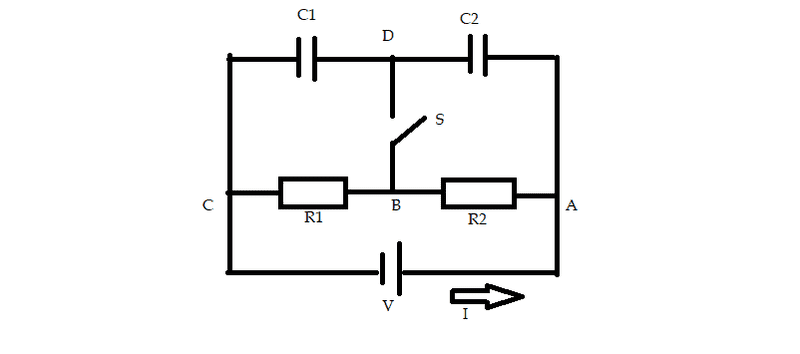

Find the Voltage in the parallel resistor-capacitor circuit
In summary, based on the information given, it seems that the voltage across C1 when the switch is closed will be 1 A and the current through C1 will be 1 A.
Helly123
581
C1 = 4 micro F
C2 = 8 mF
R1 = 4 ohm
R2 = 8 ohm
V = 12
Questions :
1) Find current I when S not closed
2) find Vb, when Vc is 0
3) find Vd, when Vc is 0
4) total charge move from B to D
Vf - Vi = F.d/q
(not sure this below is useful equations)
I = E/Z
E = E resistor = E capacitor
I total = Iresistor + Icapacitor
z = 1/(1/Zr + 1/Zc)
1) I = V/R = 12/12 = 1A. (I wonder if the capacitor will affect current? since in Q = CV, there is no current as in V= IR)
2) what makes the Vc is 0? I thought that Vb = 12 V - ## V_{resistor2ohm}## Is there any relation with Vc?
3) same as 2)
4) I thought maybe the charge referred is the charge in this equations (Vf - Vi) = F.d/q
any help is appreciated :)

To answer q4 I believe you need to assume the following steps occur...
1) the capacitors start off discharged, the switch is open and the battery is disconnected.
2) the battery is then connected and the capacitors charge so a voltage appears on D and another voltage, possibly different, appears on B.
3) the switch is made/closed connecting B and D.
4) if the voltage on B and D calculated in step 2 was different then current would flow until it was the same. They are asking how much charge flows.
Start by working out the voltages at step 2. You have already calculated Vb so just need to calculate Vd.

More help...
With the switch open...
The current through the resistors is 1A so VBC = 4V.
How to work out VDC... If the capacitors start off discharged then when the battery is connected they will quickly charge up. The charge that flows is the same for both capacitors because they are in series.
The general equation is Q=CV. If the charge is the same you can write...
C1* VDC = C2* VAD
You also know that..
VDC + VAD = 12V
If you solve these equations you get..
VDC = 8V
So with the switch open there is 4 volts across the switch.

That is the answer I got...
The voltage across C1 changes from 8V to 4V. Q= 4*4*10-6 = 16*10-6C
The voltage across C2 changes from 4V to 8V. Q= 4*8*10-6 = 32*10-6 C
Both lots of charge flow through the switch so the total charge is 48*10-6C from D to B
Likes Helly123

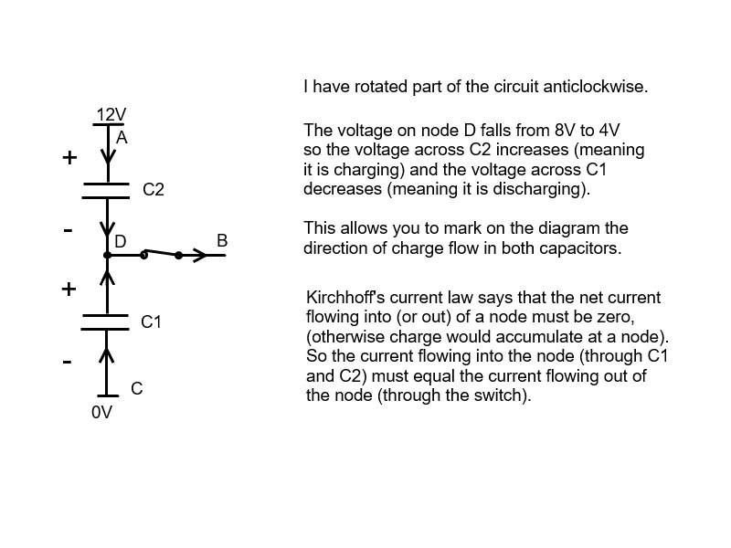

I will try and post a diagram.
yes please

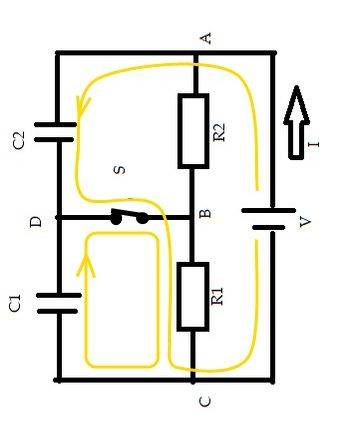

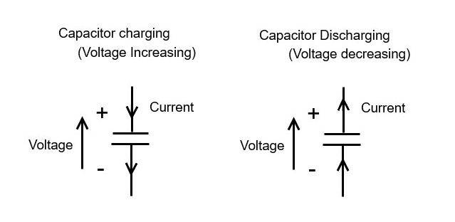

Two diagrams. First shows the direction of current flow when a capacitor is charging or discharging...
Second diagram shows which capacitor is charging and which is discharging in your circuit...
if the voltage in C1 going through the switch, how about the voltage in D to C nodes?
the voltage in D to C nodes is 4V, the voltage still going circle in the circuit, but causes charges to move in the switch is that it? is that the voltage in D to C the same as D to B, because D-C and D-B parallel?
charges in C1 and C2 going through the switch (D to B) does it also go to D to C to A ?
Helly123 said:
if the voltage in C1 going through the switch, how about the voltage in D to C nodes? the voltage in D to C nodes is 4V, the voltage still going circle in the circuit, but causes charges to move in the switch is that it? is that the voltage in D to C the same as D to B, because D-C and D-B parallel?
I do not understand your question. In some places you say "voltage" when you mean "current"?

1) With switch open..
The voltage on node D (with respect to C) = 8V.
The voltage on node B (with respect to C) = 4V.
2) When the switch is closed...
Node D is connected to node B. This means node D and B must have the same voltage. How do we decide if this is 8V or 4V? I will explain how..The voltage on node D cannot change instantly because of the capacitors...

dV/dt cannot be very large because it would need a very large current (dQ/dt).
If the voltage on node D cannot change quickly then the voltage on node B must change because they are connected by the switch. So what happens is the voltage on node B shoots up from 4V to 8V. So now both node D and B become 8V. This is shown in the middle of the graph.
3) After that the resistors keep trying to "pull" the voltage on node D/B from 8V back down to 4V. This is the curved part of the graph in #21.
During the curved part of the graph current flows like this..
4) After some time the nodes D and B reach 4V and the two current shown stop flowing.
Likes Helly123
