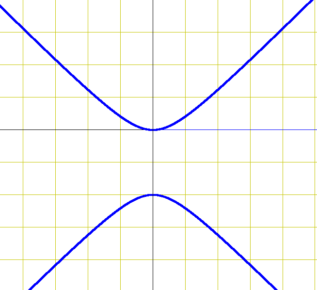

The region bounded by the curves is rotated about the specified axis. Find the volume of th eresulting solid by and method.
[tex]x^2 + \left( {y - 1} \right)^2 = 1[/tex]
First question want it rotated about the x-axis, the second question wants it rotated about the y-axis.

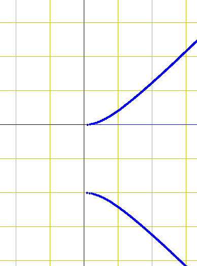

So I re-write it in terms of x. Seems easier than in terms of y since there's only 1 x term.
[tex]x = \sqrt { - y^2 + 2y}
[/tex]
The problem is when I graph it,
So nothing is bounded. There is no solid to rotate. Should I have solved in terms of y instead? How would I do that?

It still seems like there is no bounded region. All the other problems in this section give a second curve, usually a line like y=2, just to bound the curve. What am I doing wrong? Did I properly solve for x?
You have lost a "sign". x2+ (y-1)2= 1 is obviously a circle of radius 1 with center at (0, 1), not the hyperbola you show.
[tex]x= \pm \sqrt{1-(y-1)^2}= \pm \sqrt{2y- y^2}[/tex]
and
[tex]y= 1\pm \sqrt{1- x^2}[/tex]
lol... and I should have recognized that the answer in the back of the book, 4pi/3 is the volume of a unit sphere. Without the r^3 in the formula I didn't recognize it.
