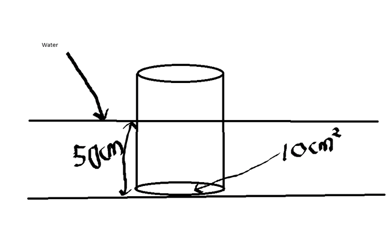

Hello, there is a cylinder with cross sectional area 10cm2.
The cylinder has a length of 50cm partially submerged in water and floats upright.
Taking acceleration due to gravity as 10 m s-2 and the density of water to be 1000 kg m-3
Find the weight of the cylinder using archimedes principle.
Upthrust = volume *density *gravity
Upthrust = mass of water displaced *gravity
So, I found the volume of the part of the cylinder that is submerged by multiplying the cross sectional area by 50cm and got 500cm3
From here I converted that that to metres and then used the formula for upthrust involving density and gravitational acceleration and I got 0.05 N
Now I use the knowledge that the upthrust = mass of water displaced * gravity
so 0.05N= Mw*10
Mw= 0.05/10
Mw = 0.005Kg
So now know the mass for that part of the cylinder, but the problem is they didnt inform me of what fraction was submerged, so I don't know how to find the mass for the whole thing.
If I did I would use F=ma and solve.

The upthrust must also equal to the volume of water displaced, my calucation was this, 10cm2 is 0.001m2
Multiply that by 50 cm or 0.05 m and you will get 0.0005 so multiply that by 1000 you get 0.5 multiply by 10 you get 5
SO the upthrust is actually 5 Newtons and I'm guessing the volume is 5mcubed for that part of the clinder

What are the forces on the cylinder?
The forces on the cylinder are the force of grvity acting upon it, and the upthrust.
Also I am sure I fixed this calculation now, it should be 50N is the upthrust
So what equation can you write?
Likes Richie Smash
I included a diagram here.
The equation I can write is
Mass x gravity = volume * density*gravity
However as you can see in the diagram, this would only be for the section of the cylinder underwater, my problem all along is how do I know figure out the weight, or mass or volume whichever one of the rest on top, because according to my calculation the upthrust is only equal to that section of the cylinder, and my thinking is, I need the height of the entire thing because I only calculated the volume of one section of the cylinder, but they don't give any fractions or hints in this question.

No, just an equation connecting the forces on the cylinder.
Ok it will be,
Fb=mg
Richie Smash said:
Ok it will be,
Fb=mg
It is however the force of buoyancy (which is only on part of the cylinder) compared to the ##mg## which is of the whole cylinder.
So put it all together:

Archimedes principle states that the upthrust on a partially or fully submerged object in a fluid is equal to the weight of the fluid that is displaced.
Well I can figure out that using
Fb=mg
The mass of the cylinder I have found would be 5kg. I know I'm missing something vital here... but it just is not adding up to me.
As Lekh stated in this equation, the ''Fb'' term would be the force only on part of the cylinder, so using the formula, would the 5kg mass I have computed = to the entire mass or just part of the mass, if it the entire mass then problem solved but if not...
Fb=mg
That is ambiguous because there are two masses.
To be clear, you successfully used Archimedes' principle (some numerical errors aside) to arrive at
Fb = mwater displaced g
The equation it took so long to add was Newton's ΣF=ma:
Fb - mfloating object g = 0
Yes, but you are asked for the weight, not the mass.
SO the weight is 50N?
Assuming the mass is ##5 kg## and the acceleration due to gravity is ##10m/s^2##
