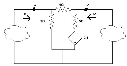

Find the Y-parameters for the following two-port circuit
Node 1 :V1(1/3+1/4)-1/4V2=I1
Node 2 : -1/4V1 + V2(1/4+1/5)-1/5(2I1)=I2
Subtitute I1 from the first equation to second equation, we have :
I1=7/12V1-1/4V2
I2=-29/60V1+11/20V2
So y11=7/12, y12=-1/4, y21=-29/60, y22=11/20
But the solution gives me that y12=1/4 and y21=29/60, there are differences of signs. I haven't found my mistake.
Could be you haven't made a mistake! Your results look okay to me.
Your answer is correct. The "solution" is wrong.
