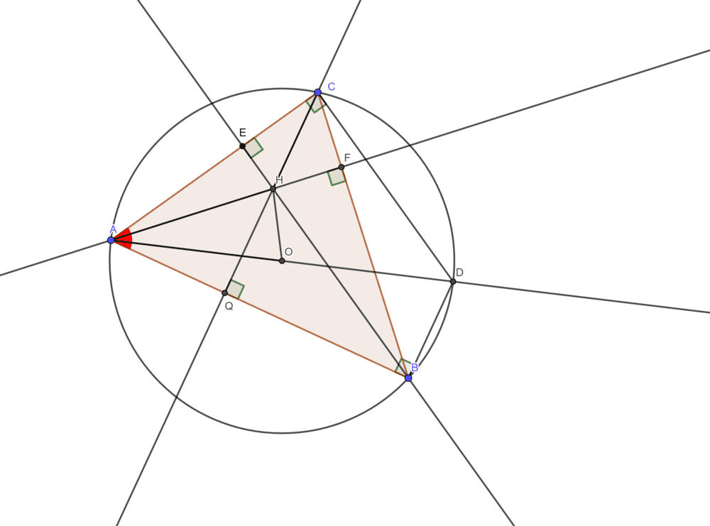

An acute ##\triangle ABC##, inscribed in a circle ##k## with radii ##R##, is given. Point ##H## is the orthocenter of ##\triangle ABC## and ##AH=R##. Find ##\angle BAC##. (Answer: ##60^\circ##)
243002
##AD## is diameter, thus ##\angle ACD = \angle ABD = 90^\circ##. Also ##HBDC## is a parallelogram because ##HC||BD, HB||CD##. It seems useless and I don't know how to continue. Thank you in advance!
What drawing program did you use to make that figure?
I've used GeoGebra.

I don't get what you are trying to say. If you try to draw the same picture with an angle of ##70^\circ## you don't get the lengths ##AH = AO##.
So, you can continue by showing first portion A is equal to the third portion A, Then try to use trigonometry since AH=AO=R and AD=2R, and then you will get the answer.

I'm 8th grade - I do not know Trigonometry.
What about similarity? It can be solved by it.(I don't know how is your country's education system)
And another clue to solve the problem: After you showed that the first portion A is equal to the third portion A, then by this and by knowing that AH=AO=R and AD=2R , try to prove 2AE=AB (by similarity)
