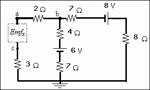

A DC circuit which includes Emfx of unkown magnitude and orientation, at the location indicated is shown below. Note the 'ground' (V=0) in the circuit.
The potential between 'b' and 'a', Vb-Va, is measured to be 2.00 V.

First, to simplify this circuit, I added up all the resistors which were in series, so instead of having 6 resistors, I now have 3.
So my R1=5ohms, R2= 15Ohm, and R3= 11Ohm.
for a, I tried solving for the E magnitude by doing V(gE)= VE-Vg (Where g Vg is ground voltage which equals to 0). I don't know how the Kirchoff's law could help me with this.

Just before you simplify the circuit by combining the resistances, can you think of any interesting information you can tease out of the circuit from the given information? (hint: why do you suppose Vba was given?)
I may sound stupid, but I honestly have no idea how the Vab could help me with this. I calculated the current flowing from b to a, which gives me 1A...does this help me in any way?
This assignment is due in 8 hours!
Knowing the current that's flowing into node b from that branch allows you to write the node b KCL equation without having to know what Emfx is. That will allow you to calculate the voltage at that node independently of Emfx. Knowing that current also allows you to calculate the voltage across the 3 Ohm resistor...
Okay this is what I am doing:
I3= I1+I 2
E+6-11(I3)-2= 0 ----> E+4-11(I3)=0
8+6-11(I3)-15I2=0
14-11(I3)-15I2=0
I3= 1.27-1.36I2
How do I find E?? I am so close! I know it
You have overlooked the 3 ohm resistor, otherwise your working is correct.
Solve your 3 current equations to determine I3, then substitute into the above equation (when corrected), to find E.

Okay, I got the correct answer for EMF, but now I can't get b).
I treated I1 as the 1 A current, and I3 is therefore 1.14 A. It works out, because I plugged in those values to get EMF. So then I2, which is equal to I3-I1 gives me 0.14 A, but the answer given is 0.929 A.

Can you provide a diagram that indicates your current choices and directions? Also, it would help if you could provide details for your calculations (equations).
