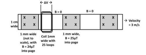

You can slide your (old style, magnetic strip) credit card in a reader, and it somehow gets your credit card number. How does it do this?, Explain, with appropriate equations, what voltage ∆V you will see (as a function of time) if you slide the strip – with its magnetized regions – past a reader coil of wire as shown above.
motional emf = vBL, emf = dΦ/dt
emf = dΦ/dt = (B*A)*d/dt = B(dA/dt), dA/dt= L*d/dt(vt) = L*v, emf = B*L*v per coil
Since there are 25 loops the total emf= 25(vBL) This is where I'm am stuck. Would I assume that B is 24 uT, the velocity as 3m/s , and the length as 1mm? If so I would get ∆V as 1.8*10^-6.

Sound reasoning. I think you have the right amplitude. But the exercise asks 'what voltage ∆V you will see'
So can you describe what the signal looks like ? (e.g. 'it's a sine wave')
There are several lengths depicted in the diagram. Which one should be used for L?

In case you haven't figured this out yet, you should consider your calculations at several different scenarios.
What's the voltage when a magnetized region is in the process of entering the coil's area?
What's the voltage when a magnetized region is in the process of leaving the coil's area?
Also, according to your diagram, some magnetic regions have the magnetic field [itex] B = 24 \ \mathrm{\mu T} [/itex] while others have [itex] B = 25 \ \mathrm{\mu T} [/itex]. I'm not sure if that's a mistake or not, but you shouldn't ignore it unless you are given a correction.
