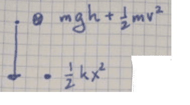

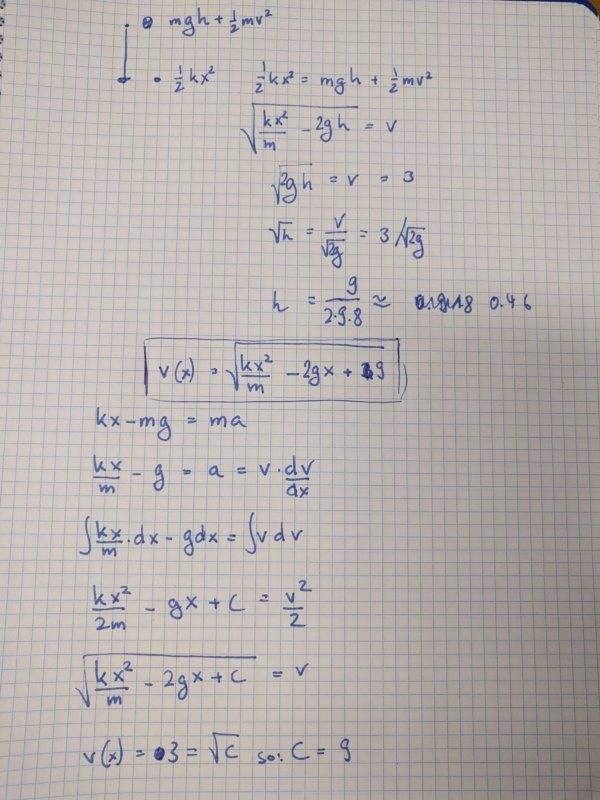

I tried using energy conservation to check my work, but I think I messed up. I boxed in my solution. Above is me trying to verify with the conservation of energy and below is my attempt.
Hi all, I have a problem that I've been grappling with for the past 2 hours.
I was confident at first that I found the correct solution, but when I tried to verify I didn't have a constant in my v(x) function.
Here is my attempt:
I appreciate your help kind internet strangers!

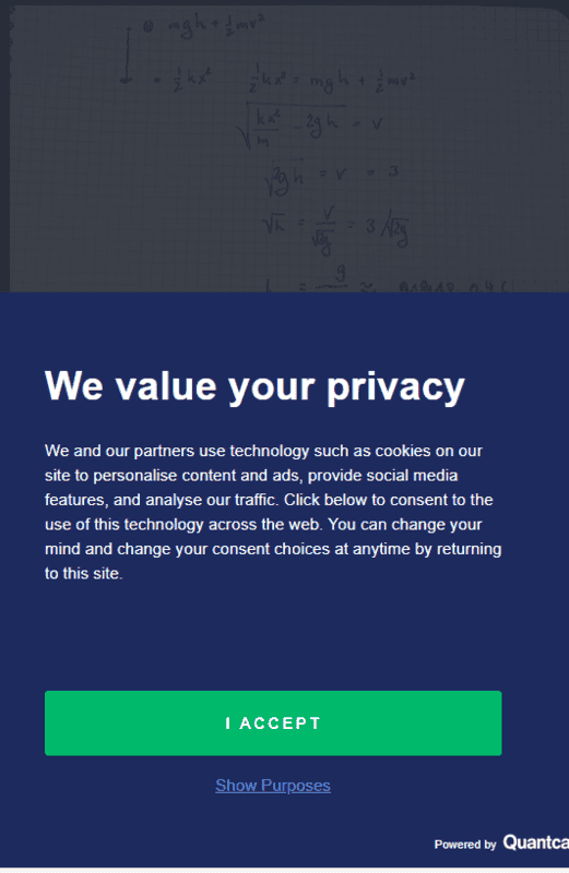

but someone else boxed 'We value your privacy' over your picture and I don't want to give them access to my computer.
What also throws me off is that they gave me k and m, but I didn't need it for my solution :oops:
I'm sorry, I don't understand?
https://www.physicsforums.com/attachments/244545
I'm sorry I can't open your attachement, page not found.
Do you get a cookie notification from imgur? Meaning I should repost my picture?
I try uploading it as attachment.

Hi, can you see my attachement https://www.physicsforums.com/attachments/img_20190603_172630-jpg.244546/ (i am asking because I seem not to be able to open all)
When I solve for v(x) with differential equations and when I use conservation of Energy I get two solutions that differ by a constant 9 under the square root.
The function itself is also weird shouldn't v(x) eventually come to 0 when kx = mg?
I was misled by the layout of your working. I thought you were comparing the boxed equation half way down with the final one.
Right at the start I see you have ##\frac 12kx^2=mgh+\frac 12mv^2##.
Please explain the basis of this equation and what h represents there.
Soon after, you quietly dropped the minus sign in ##\sqrt{-2gh}##.

Hi Haruspex.
Yes, I'm sorry the layout is bad I see that now. I had the work on another sheet and I actually thought it would be more clear this way.
The above is me trying to verify my solution by using conservation of energy.
This is what I thought:
At the middle where v is at it's maximum and x = 0 there is only potential energy mgh (or mgy) and the kinetic energy which is at it's maximum there.
On the way down the spring force works against the kinetic energy and gravity, i.e. pulls the mass up.
if we say that h= 0 where kx = mg then all the energy there, at the bottom so to say is(1/2)*k*x^2
##\frac 12kx^2##. So all of the potential energy and kinetic energy turned into potential spring energy.I dropped the minus sign because g is negative (-)(-) = (+), but I've wondered about whether I made a mistake here myself already, I actually dreamt about it.I thought at the bottom v should be zero for a short time and reverse. I was imagining it.

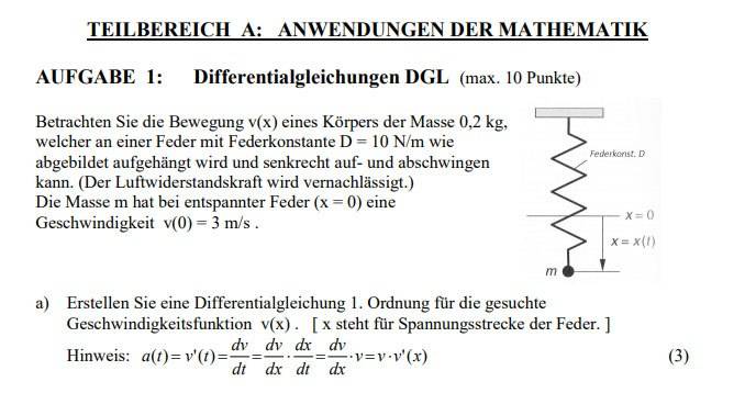

The exact problem is two parts, a and b.
a) Find a 1st Order differential Equation Expression for v(x).
b) Solve the Equation you found for v(x)
it's from an old swiss high school physics exam.

But your energy equation is still wrong. The total energy is constant. Rewrite the equation to express that.

Hi Haruspex,
I am sorry!
It actually only says at x=0 where the spring is relaxed v = 3 m/s. Assumed that this must be equilibrium and attempted to translate.
There is a diagram with it. I attached a screenshot.
I will redo the equation and see if I can get the two to mean the same thing!
thank you very much.
there also is a hint with a = v*dv/dx, which is why I went with kx-mg=mv*dv/dx

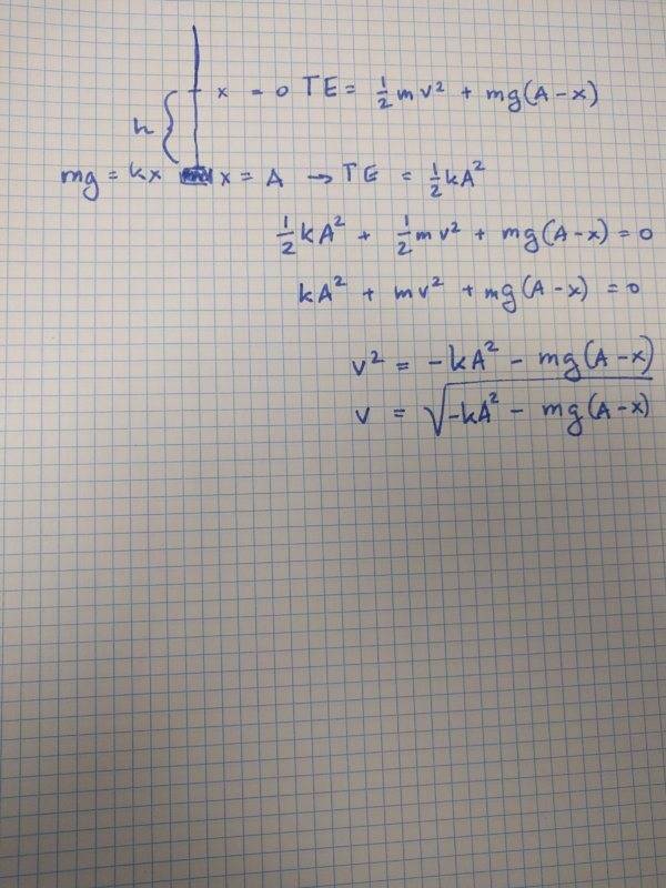

Hello Haruspex,
Thank you very much for your help.
I gave it a lot of thought, and by myself, I still didn't quite get what's wrong.
But by your hint, I think I may have figured out what the right equation is.
I rewrote it and uploaded it as an attachment, together with a drawing which attempts to explain my thinking in how I got the first equation.
Would you mind checking if the new equation is correct?
I changed h to be A-x, where A is the amplitude.
I am sorry if I'm a bit slow, I haven't had formal schooling, and I found that I sometimes taught myself things the wrong way when it's way too late. But that's why I also really appreciate the help, like having a teacher!

It's rather hard to follow your working without some explanation. Don't worry about the amplitude for now. That is a "boundary condition" we can plug in later if appropriate.
You are defining x as displacement from spring’s relaxed position. I'll assume up is positive.
At x, you have that the elastic PE (EPE) is ##\frac 12kx^2## and that the KE is ##\frac 12mv^2##
What is the GPE (relative to x=0)? So what expression do you get for the total energy at x?
Next, plug in the known values at x=0 to find the value of that constant energy.

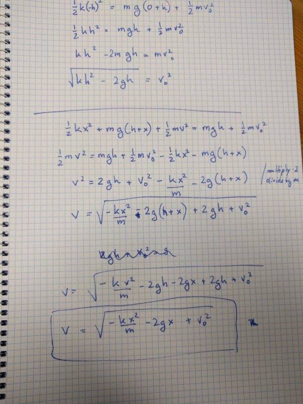

In your Original Post you had the following .
244602
So that first line refers to the total energy at ##x=0##, at which location the spring is unstretched. The gravitational potential here is referenced to some other point by ##h##.
The second line appears to be the total energy at some value of ##x## at which the gravitational potential is zero and the velocity, ##v##, is also zero. Since the gravitational potential here is zero, this must be a distance, ##h## below ##x=0## and ##h## must be positive, i.e. it must be that at this location ##x=-h##.
Thus the gravitational potential at an arbitrary location is given by ##mg(x+h)##.

Thank you haruspex, I think I see my mistake thanks to you and sammy, i'll try to rewrite it now.

I think:
The spring PE is 0 at x=0
The KE is (1/2)*m*v^2
If we take x=0 as the height being 0 then GPE is 0
So the total then would be just the KE? (1/2)*m*v^2
Yes, then the GPE is 0 at x = 0.
What is the GPE at an arbitrary value for x ?
Likes spsch
  • #33
I didn't ask about x=0. My questions are in the context of an arbitrary value of x.
Likes spsch
  • #34
Thank you. I did follow these questions which had led me to that result.
x+h? as h being the displacement from x=0?
  • #35
Oh, then 1/2*k*x^2?
I'm sorry I may have misunderstood.
29
303
31
954
203
423
930
